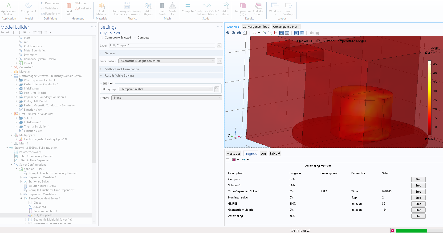

To check the effect that I mentioned, I recommend to plot the temperature profile while solving, you'll see how the hot point appears. To do so, select the Fully Coupled 1 node in Time-Dependent Solver 1, then in the Result While Solving node enable Plot and select Temperature (ht).

For the plot while solving have you edited the option from the Fully Coupled 1 node ? I just tryed it again and it was working ok.

Yes, I checked the plot option in the Fully Coupled 1 node. I've also checked other options in 'Step 2: Time Dependant' but nothing still no plot. I can only see the Convergence Plot 1 and 2. Strange... I used the model attached in this thread. Could you show me a screenshot how the plot window comes wihile solving please?

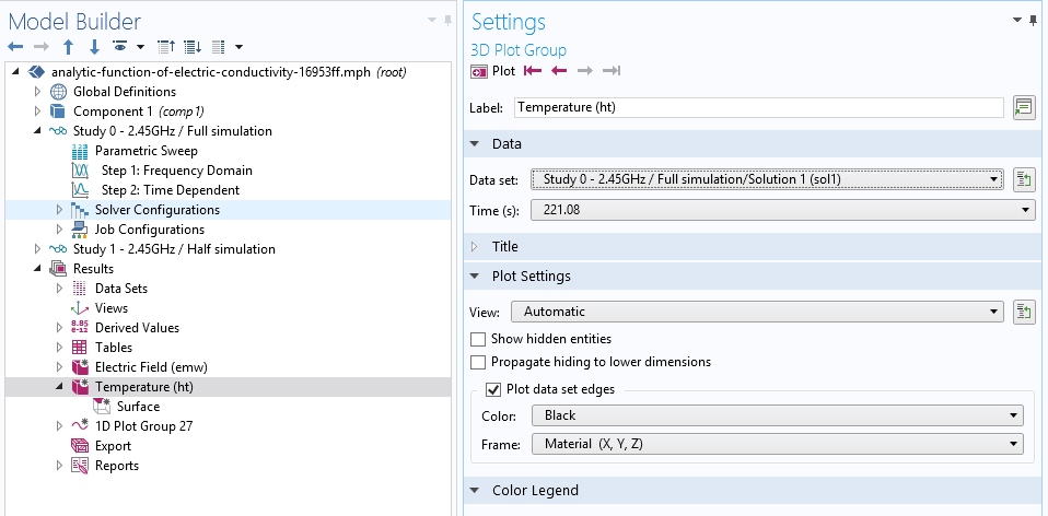

I see, you need to make sure that the temperature plot refers to the solution you are computing (sol1 here) as shown on attached screenshot temperature_plot.PNG. Then in the Graphics tab I get the temperature plot (see plot_while_solving.PNG).
Nicolas

Thanks for the screenshot. Now I know what I should look. I was expecting to see a new plot graph window appears, and that's why I couldn't see the 'Result while solving' is working. ;)

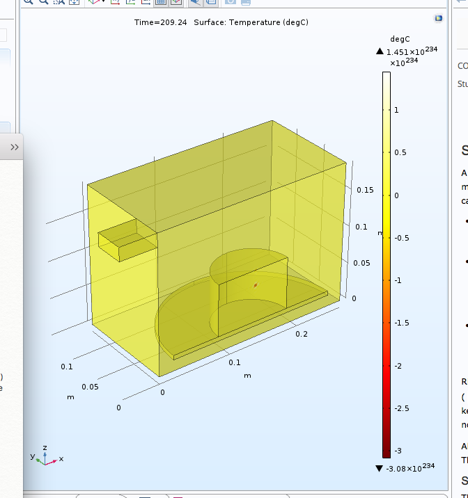

I've monitored what happens while solving the model, and have found interesting things. The temperature sparks occasionally with below cases.
  1. Material is getting really hot with a hotspot - up to 4.056E81 x1.0E81 degC.
  2. The air domain is getting extremely hot - up to 3.456E250 x 1.0E250 degC. In this case, the hotspot in the material becomes coolest point. The temperature of the hotspot is minus here (see the screenshot).
  3. When the time reaches 209 seconds, the convergence value continuously grow as high as 2.6E12, then stop with a singularity error.
I've test a simple swept mesh with the material but it only increase the computation time and get the same error. I will try more options for swept now.
BTW, I see you are using the full simulation model but I use the half simulation model. I believe that there shouldn't be any differences between them.
