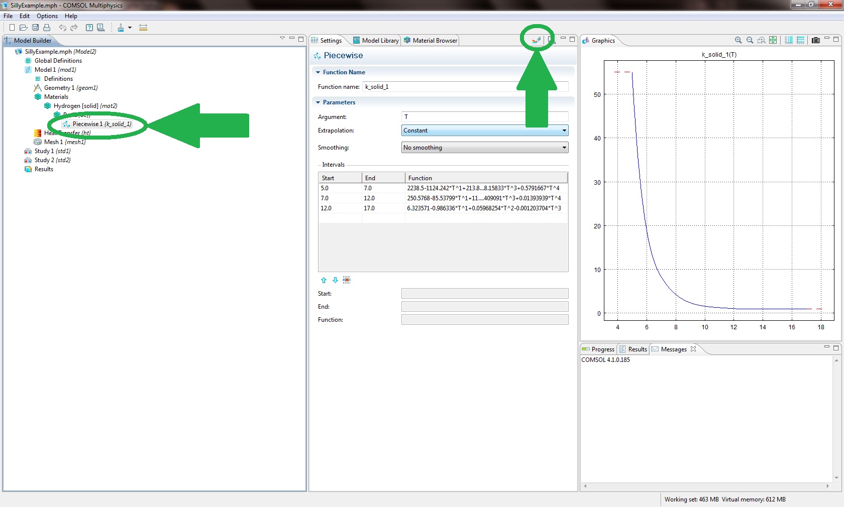

See attached screenshot.
Posted: 1 decade ago 2012/07/24 20:43 JST
Is there a way to export and save the material property data in the plot ??
[QUOTE] See attached screenshot. [/QUOTE] Is there a way to export and save the material property data in the plot ??
