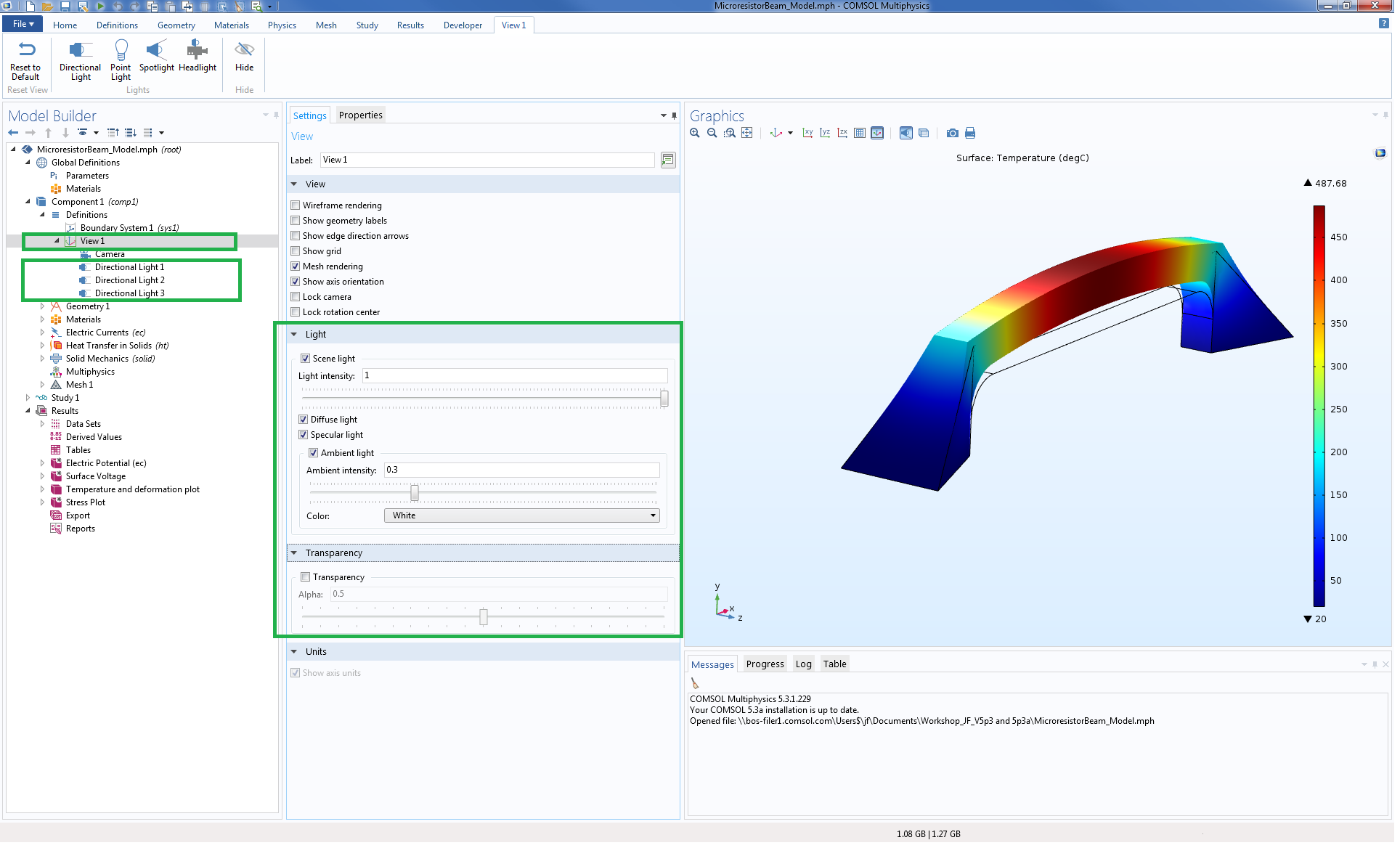

Hello everyone Tell me, please, how to remove the highlight (glare) presenting at surface in 3D plot? In older versions it was possible to determine "Reflectance of surface" dull/sunny/metall... How can I get surface without specular reflection? Thanks!

Just click the "Scene Light" icon at the top of the Graphics window.

Thank you, Jeff! Only this option? Can I change type of reflectance and/or position? The V3.5 had more options :)

Yes, there are many more options under the View node's Light tab. The above was just the shortcut to turn in on and off.

Thanks for the support, but I can not agree. For example, I can not change the transparency level, I can not set the edge color and so on. When you talk about "more options under the View node's Light tab", are you really talking about options related to lighting/reflectance? I use comsol on linux and I can only turn on/off Scene Light. Something else?

See attached screenshot.
