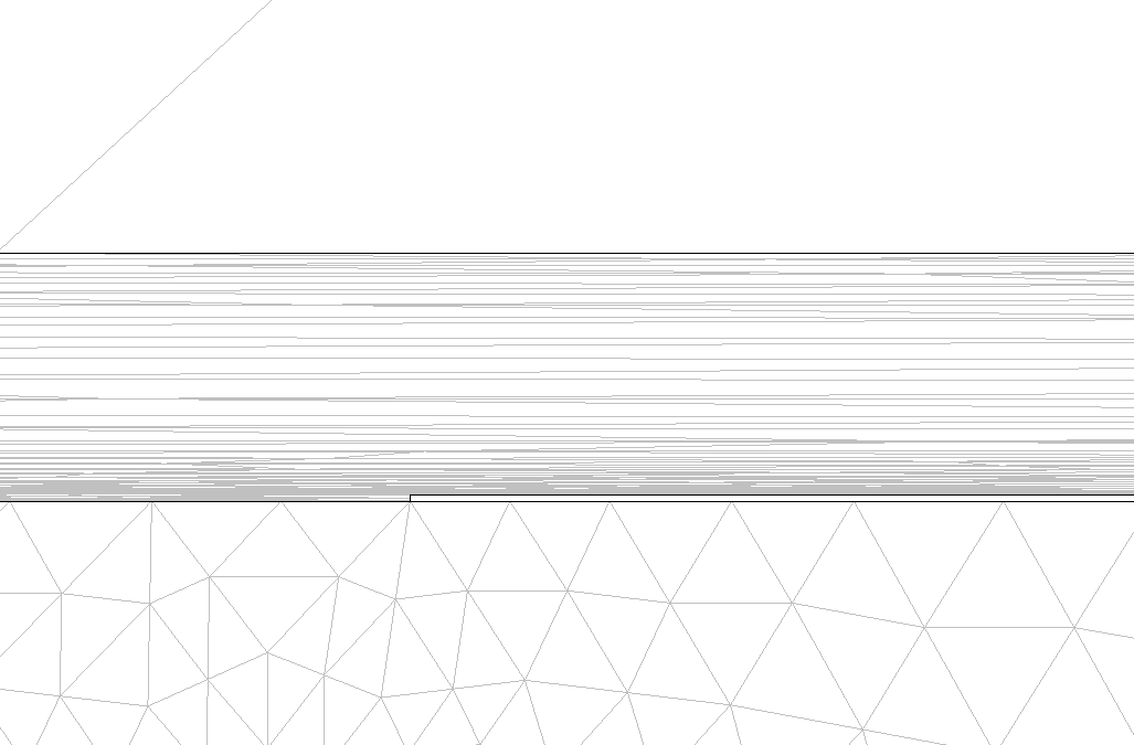

I'm trying to mesh a very thin film geometry.
x = 5000
y = 6

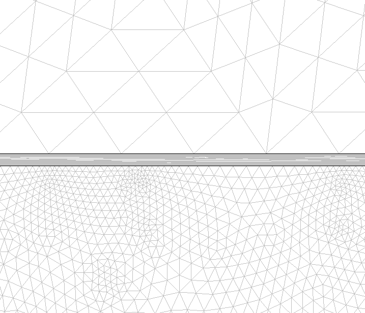

I set the x scaling factor from 0.025 to 0.0001 and get completely different results...
I see that the meshing in the thin film is kind of "sliced", there isn't many nodes in the x direction...

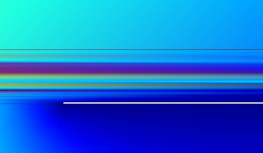

The results (electric potential) doesn't look right either.
Any suggestion?
