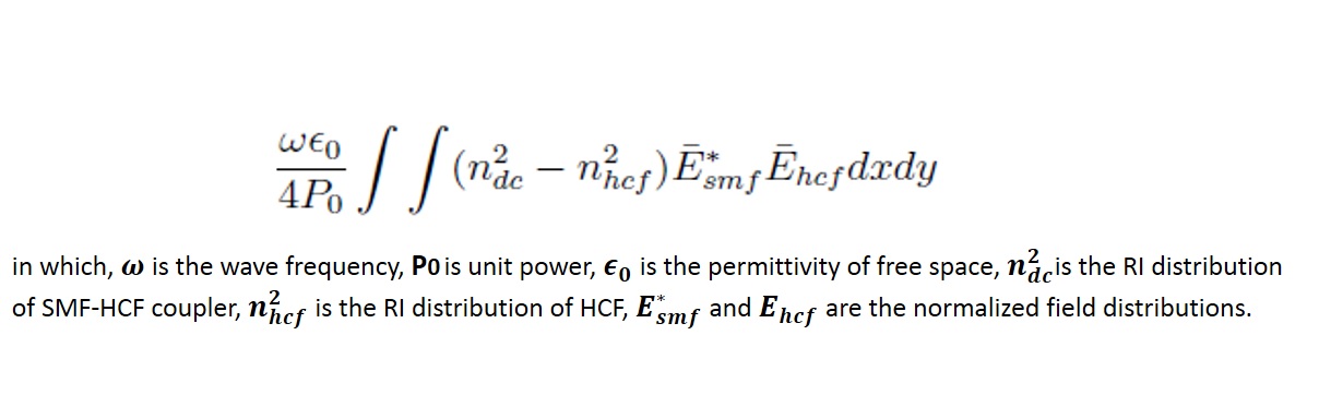

I am new to comsol. I am learning comsol with best of my ability to implement a directional coupler model and calculate coupling co-efficient from the overlap integral expression given in the screen shot.
I built two soultions, one is the single mode fiber and other one is the hollow core fiber and I need to find the coupling co-efficient "kappa". Please let me know how can I implement given integral expression using normalized fields from two of these solutions.
