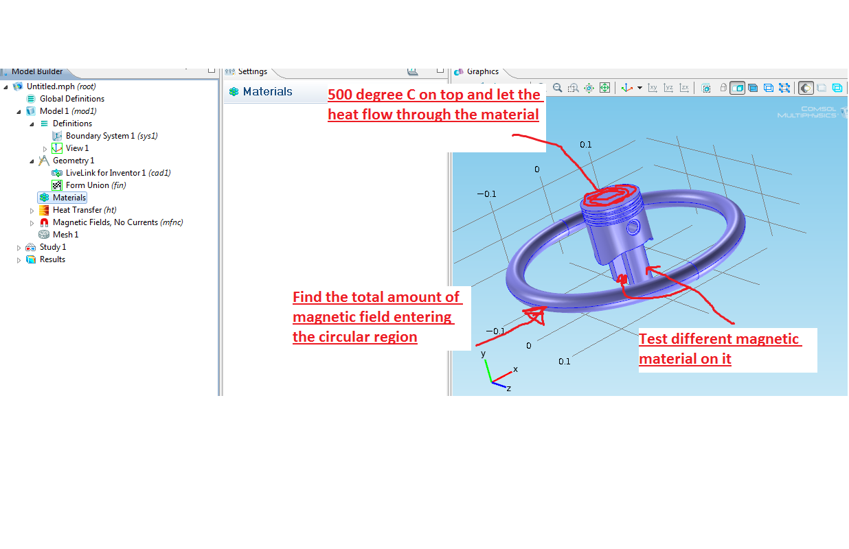

But I have model made in inventor on which i want to carry out the simulation on.
The CAD model is attach. Can you please help me step by step how to perform the test?
What I want to do is simple, 400 degree celicus to be on top of the piston head. The bars sticking out in the bottom of piston are the magnets. I want to see the the change in magnetic field, flux density and strength of magnetic field about 10 centimeter away from the central axis of the pistion. I have to calculate induced voltage.
I need to test the simulation with different permanent magnets.

see the pic for exactly what i'm trying to do... please help me on it.

I want to integrate the flux over the circular solid around the piston
You can see the save files below [attachment]
I want to integrate the flux over the circular solid around the piston You can see the save files below [attachment]
