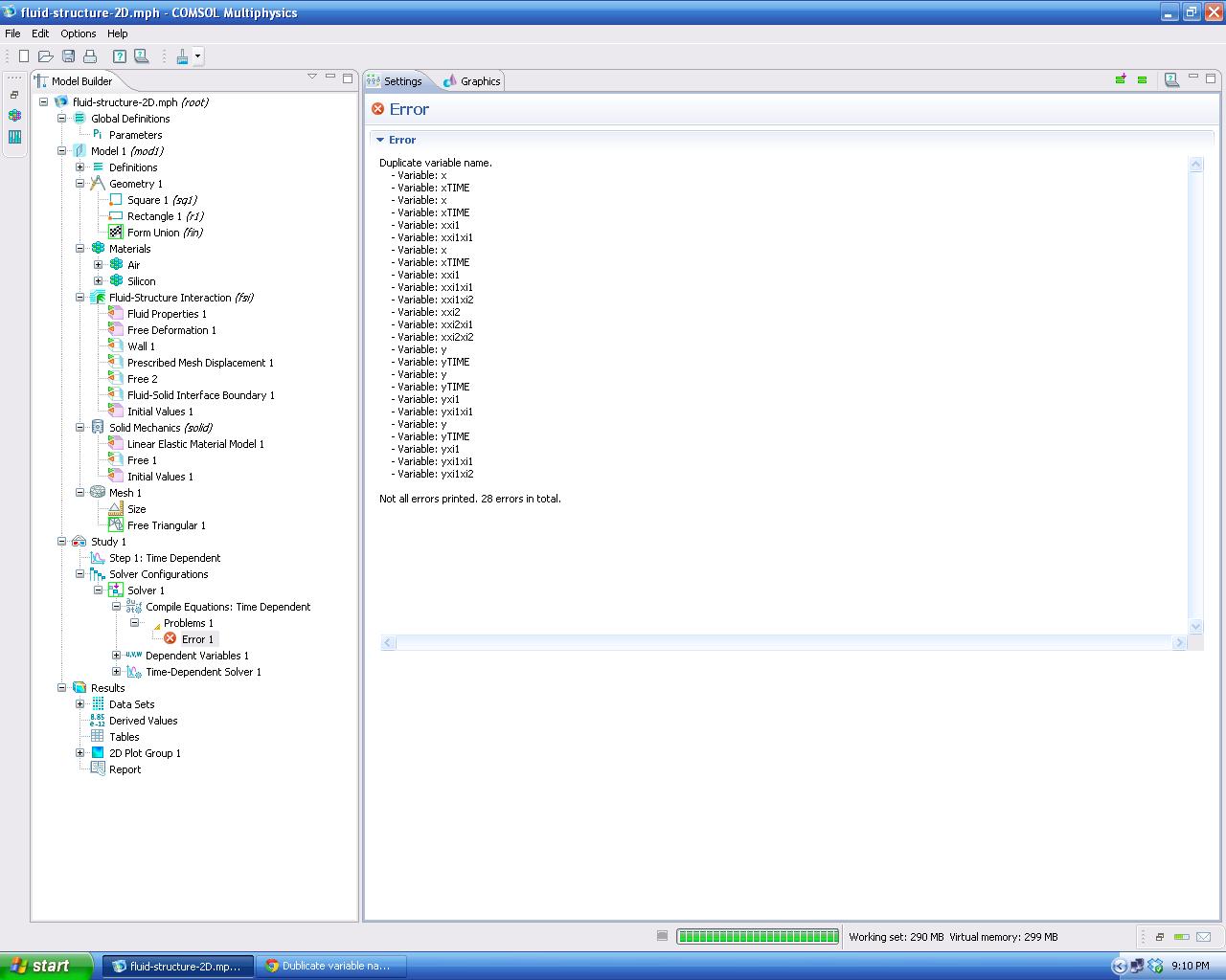

Hi,
I am getting a duplicate variable name error (see attached). Any help is very much appreciated.
Jim

Hi
it's most probably because you have FSI which contains "structural solid" physics and "Solid" physics in the same model. You are duplicating many features, and if you do not use different dependent variable names you might get "duplicated names" error. Still the names on the list are puzzling, they are coordinates and not dependent variables.
Anyhow, with FSI normally you do not need to add solid, as its already contained in FSI, under subsection Structural
Good luck
Ivar
Hi it's most probably because you have FSI which contains "structural solid" physics and "Solid" physics in the same model. You are duplicating many features, and if you do not use different dependent variable names you might get "duplicated names" error. Still the names on the list are puzzling, they are coordinates and not dependent variables. Anyhow, with FSI normally you do not need to add solid, as its already contained in FSI, under subsection Structural -- Good luck Ivar
