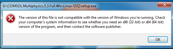

                                                    Hello Sangeerth,
The error message is pointing out that the version of COMSOL you are trying to install (5.3) does not support your 32-bit OS. You will need to install a supported OS, such as a 64-bit version of Windows, or if you have to use a 32-bit version of Windows revert to an older version of COMSOL (The last one to have supported 32-bit Windows was 5.1).
For detailed system requirements for various versions of COMSOL, see https://www.comsol.com/system-requirements/
