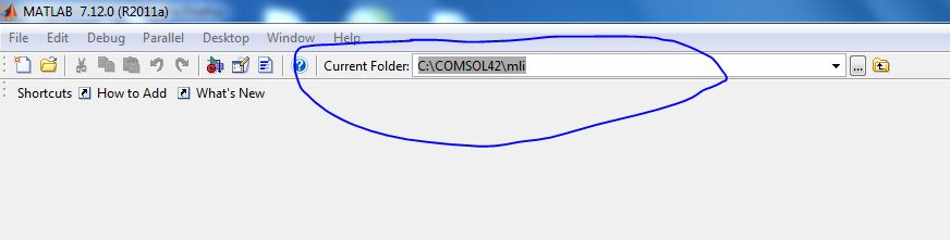

Those messages mean that Matlab doesn't know where to find the Comsol library of commands. Have you used the "import" commands from above? These need to be included in every script file that interacts with Comsol.
[QUOTE] Hi Matt, Thanks. After starting the server when I type "mphstart" in MATLAB command prompt, it says, ??? Undefined function or variable 'mphstart'. Program do not hang and Comsol server do not report any activity. Running "mphstart(2036) also gives an error message as follows: ??? Undefined function or method 'mphstart' for input arguments of type 'double'. Regards, Ashwini [/QUOTE] Those messages mean that Matlab doesn't know where to find the Comsol library of commands. Have you used the "import" commands from above? These need to be included in every script file that interacts with Comsol.

Posted: 1 decade ago 2012/07/03 7:49 GMT-4
"using mphstart"
As Matt said rightly," Matlab doesn't know where to find the Comsol library of commands".
Firstly set your current folder to C:\COMSOL42\mli
In fact, mphstart is in "mli folder". Once you set and then type mphstart in command prompt, things will work..(make sure comsol server is ON before using mphstart)..
Hi, "using mphstart" As Matt said rightly," Matlab doesn't know where to find the Comsol library of commands". Firstly set your current folder to C:\COMSOL42\mli In fact, mphstart is in "mli folder". Once you set and then type mphstart in command prompt, things will work..(make sure comsol server is ON before using mphstart)..
