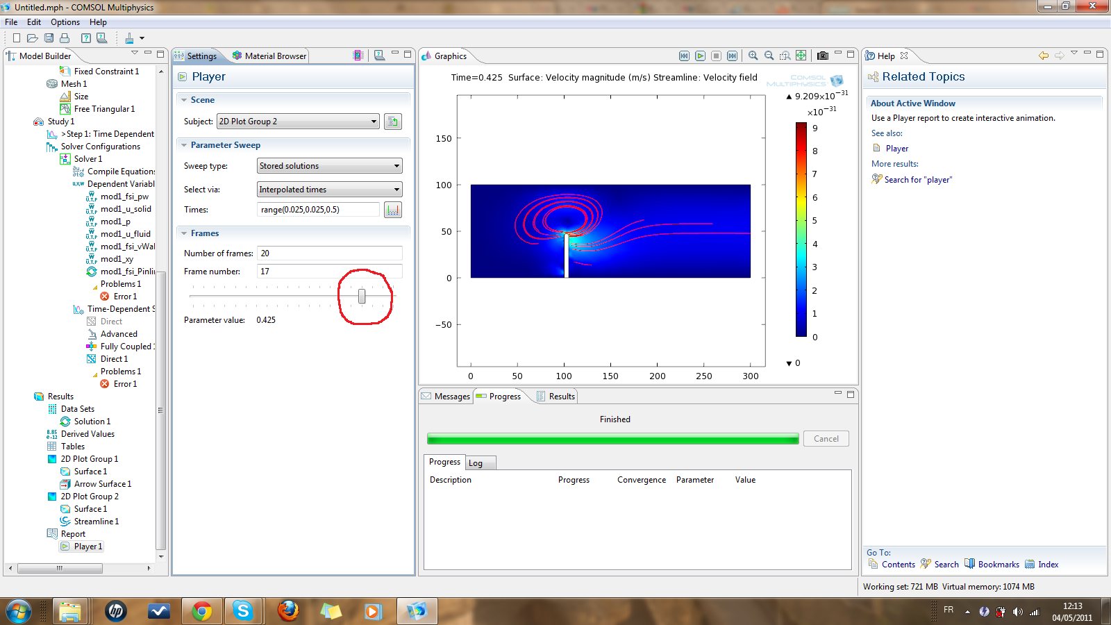

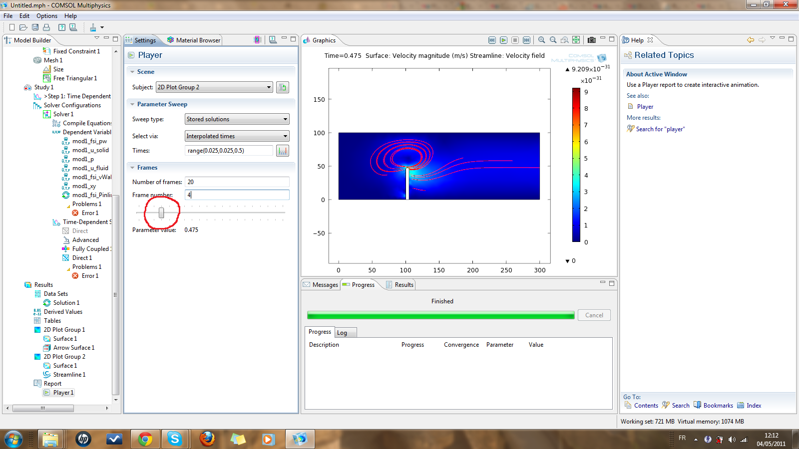

I want to modelize an fluide-structure interaction, I tried the model proposed by Comsol's website but I have run the simulation and it shows no results and no changes of any kind. i'll show you the images of this simulation. if you can help me and propose me any suggestions for this problem.

have you checked your end values ? 1E-31 ?? your device is static, you are looking at numrical noise, so you must have missed something in your simulation, basically everything is static, sop the player is showing a static motion, that's all ;)
Hi have you checked your end values ? 1E-31 ?? your device is static, you are looking at numrical noise, so you must have missed something in your simulation, basically everything is static, sop the player is showing a static motion, that's all ;) -- Good luck Ivar

Thanks for your respond, but I couldn't get a dynamique simulation.The file wich contain my model is in the attach file.
