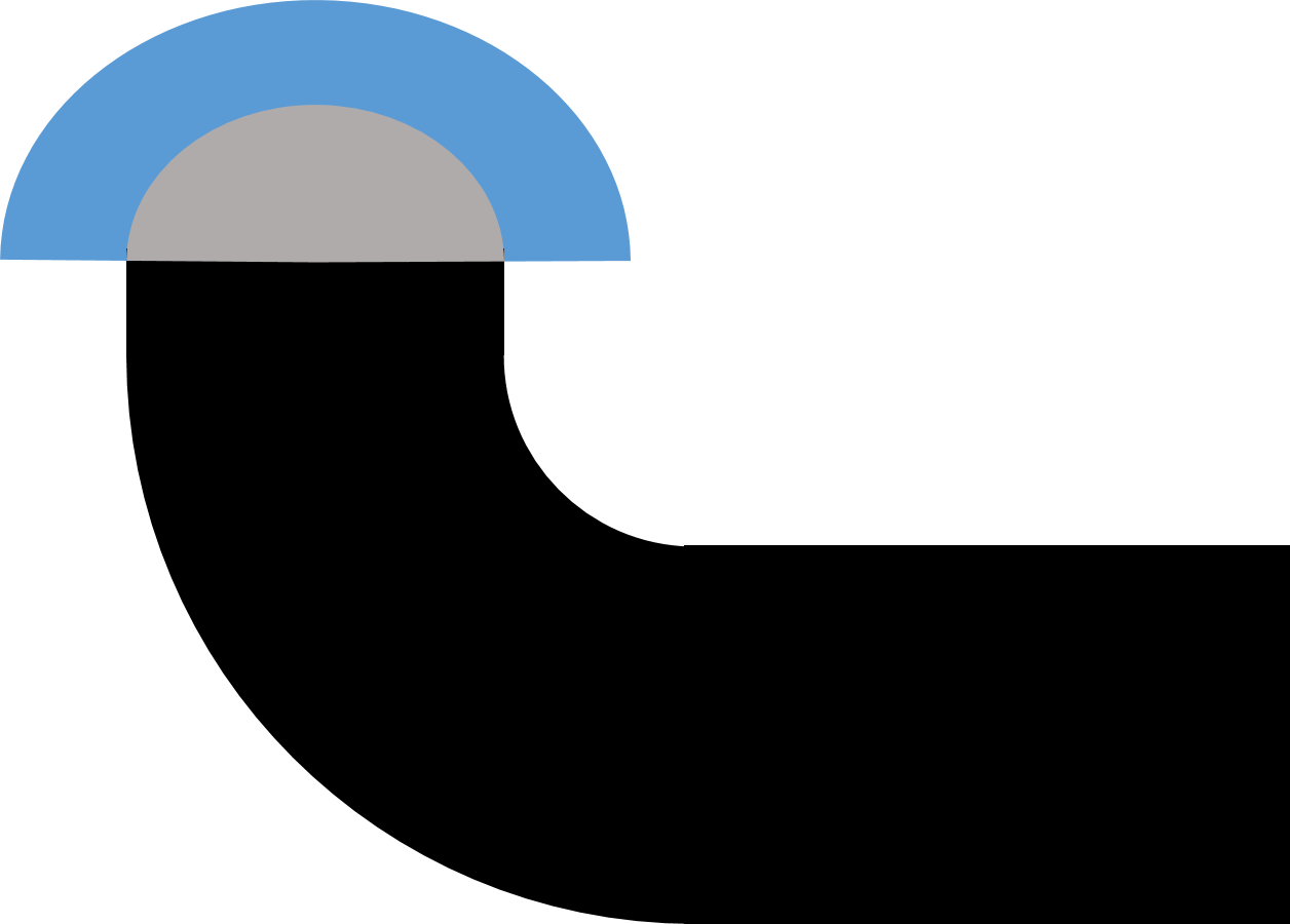

Now I do have a remaining question regarding my actual COMSOL application. I am modeling the outlet of a ventilation duct. I have enclosed a diagram of the model. The model is 3D, but this top down view should be clear enough.
The black part is the actual duct, while the grey area represents the open space to which the sound radiates. This space is surrounded by a PML. I am interested in the far-field pressure in the room. From the application library manual, I learned that calculating the far-field pressure of a source radiating into a semi-infinite space can be done by using the 'symmetry in the x,y,z=0 plane' option in the far-field calculation.
I'm wondering whether I can consider my model a plane source emitting into a semi-infinite space and should therefore use the 'symmetry in the x,y,z=0 plane' option to calculate the correct far-field pressure field.

Hi Elin, Thank you for your reply. I wasn't sure, if the it was the pressure, or the intensity that would be doubled and I coulnd't really find any clear answers elsewhere. Now I do have a remaining question regarding my actual COMSOL application. I am modeling the outlet of a ventilation duct. I have enclosed a diagram of the model. The model is 3D, but this top down view should be clear enough. The black part is the actual duct, while the grey area represents the open space to which the sound radiates. This space is surrounded by a PML. I am interested in the far-field pressure in the room. From the application library manual, I learned that calculating the far-field pressure of a source radiating into a semi-infinite space can be done by using the 'symmetry in the x,y,z=0 plane' option in the far-field calculation. I'm wondering whether I can consider my model a plane source emitting into a semi-infinite space and should therefore use the 'symmetry in the x,y,z=0 plane' option to calculate the correct far-field pressure field. Kind regards, Thijs
