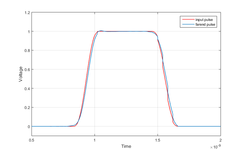

I am new to COMSOL and currently running a very basic simulation that I have many rectangular pulses. I am just wondering how I could to calculate the delay time between these pulses.

Thanks for reply, sorry, and hope to bear with me, but i dont have idea about how to do that in comsol and if I do that does it give the time at which moment, as I'm interesting in the delay time of the signal at the 50% and 90% of the rise edge.
