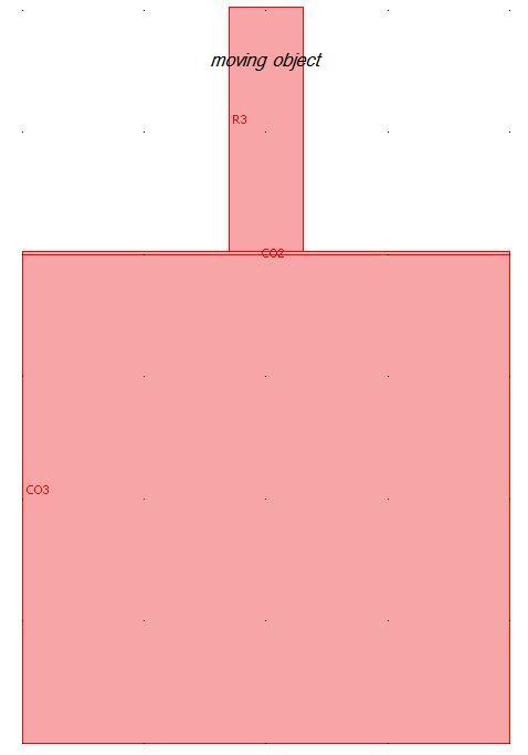

                                                    Hi Ivar,
I have the following problem if you can help me:
I am trying to build a model of one object that moving with different speeds and come in contact with other object (see attachment), what i want to know How can i model the object to move with different speed and how can figure out the Vonmises stress during the simulation
Thanx
Ali
