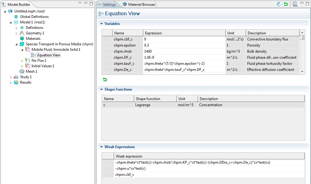

Posted: 1 decade ago 2011/05/10 8:53 JST
There should be TWO time derivatives: one for the concentration (c) and one for the porosity (chpm.theta).
Please look at eq.3-107 in the attached pdf of my second post.
I work in 1D.
Have a look at the weak espressions in the attached jpg here, and compare with eq. 3-107: the second time derivative is not there, as if porosity was considered constant.
No matter the value of the porosity (I tried many things: time dependent polynomial, etc.), the second time derivative never appears.
I'm running 4.1.0.185.
Hi, There should be TWO time derivatives: one for the concentration (c) and one for the porosity (chpm.theta). Please look at eq.3-107 in the attached pdf of my second post. I work in 1D. Have a look at the weak espressions in the attached jpg here, and compare with eq. 3-107: the second time derivative is not there, as if porosity was considered constant. No matter the value of the porosity (I tried many things: time dependent polynomial, etc.), the second time derivative never appears. I'm running 4.1.0.185.
