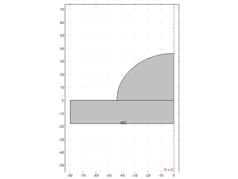

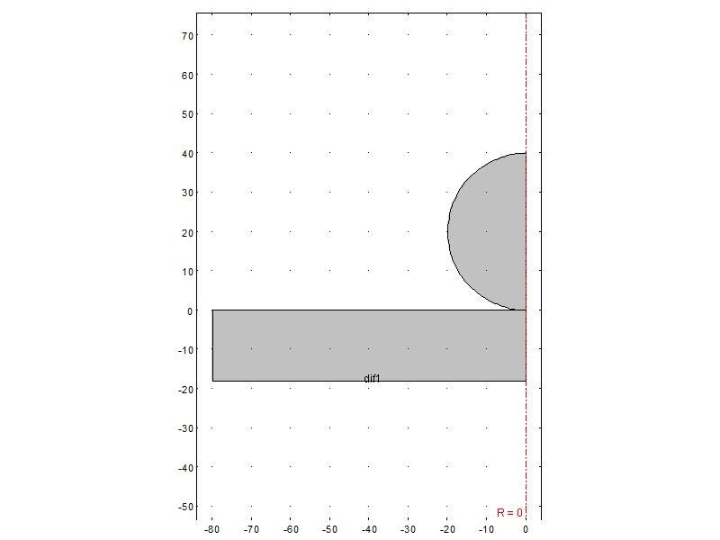

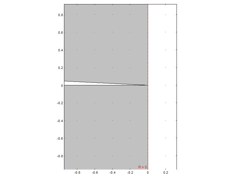

I attached three files:
1) in the first one you have the geometry that I want to start with.
2) in the second one you have a snapshot that wants just to point out that the initial concact beetween the surfaces is just a point.
3) the third one is approximately what I expect as a solution.
