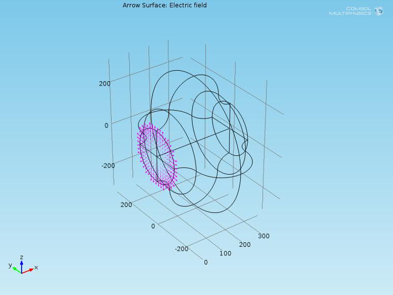

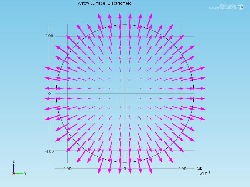

Hello Robert Koslover Thank you very much for your nice explanation. I still have dificulty come up with my expressions for input electric field. I have a cavity which is not a cylinder ( please see attached images) . I would like to create a THz source in RF Module in such a way that the electric field of the incident THz wave contanies radially orinted vectors and have a hole on the symetry axis and the wave propagates along x direction. I have already been trying it for 3 weeks and still couldn't find any solution. I use COMSOL 4.3 and this version does not contains circular port. (only rectangular port). I am intrested radiating spatial distributon not for comunication purposes. I apreciate any idea and thank you in advance for your time and considerartion Kind regards Mozhgan
