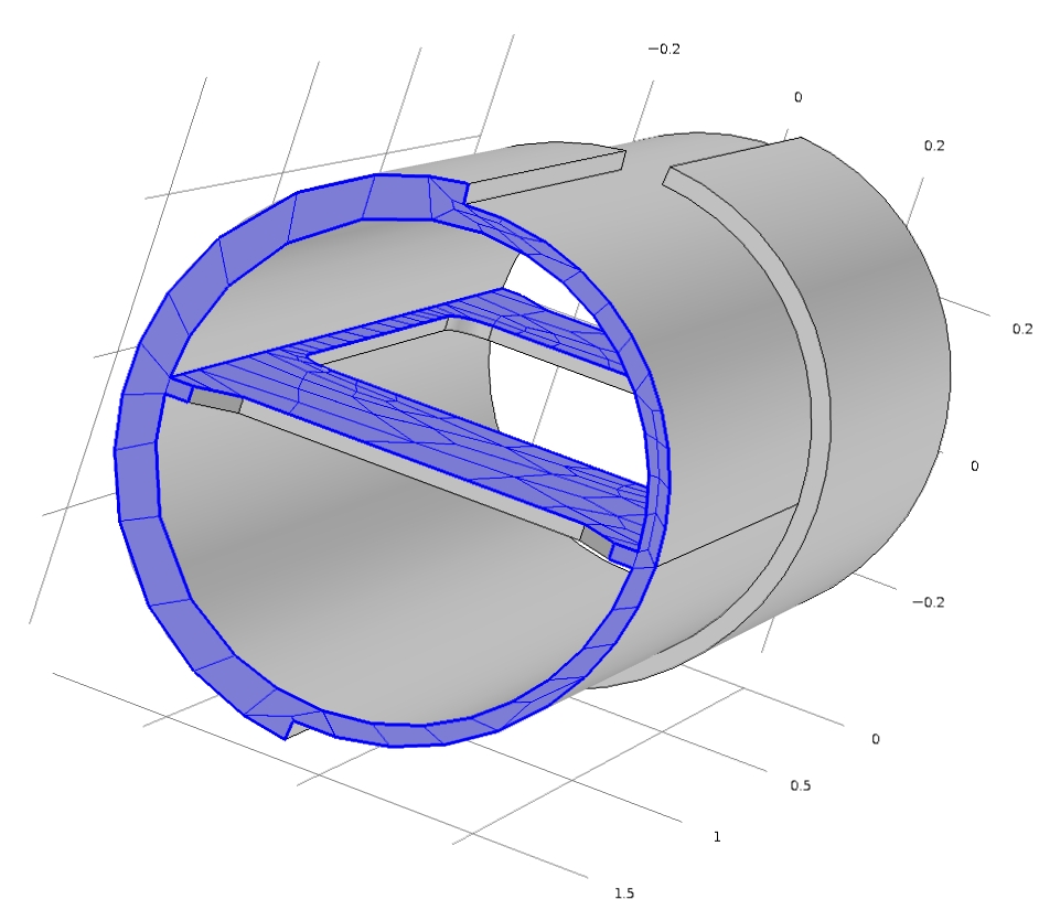

I have this pivot shell ,a cylinder with a thin diafragm along its inner surface (photo is attached if you are interested) and i need to manually mesh the geometry and bring the total number of elements to around 200.
the cylinder is 1.6 in long , 0.7 inch outter diameter and normal automatic meshing gives me around 8000 elements.
problem:
I take one end of the cylinder and one face of the diafragm and perform a quad surface mesh, then i try to sweep this surfaces through the entire geometry but i get errors all the time. seems like comsol can not handle sweeping through a geometry when quad surfaces' normal vectors are not aligned. Also, my geomtry is one unit and not an assmebly therefor i can not choose more than one surface as sweep target and since I initially had two or more source surfaces that just doesnt work.

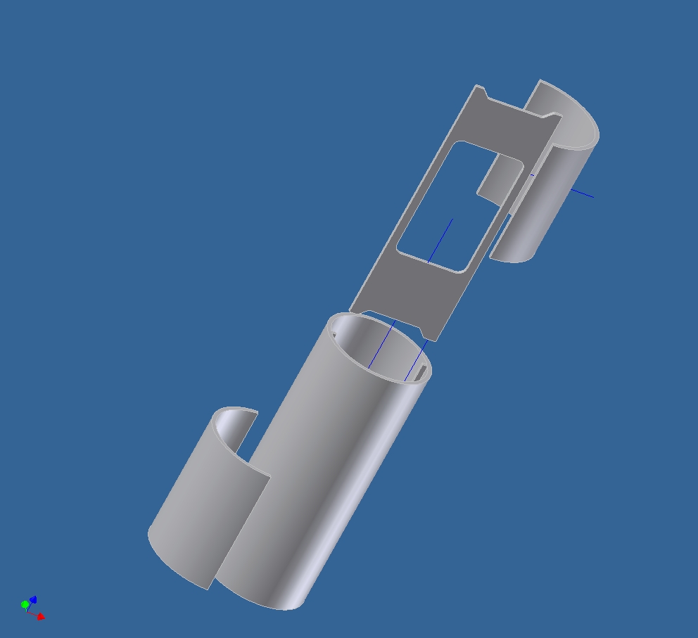

So, I did manage to mesh my model and I dont really like how i did it ,or actually how comsol wants me to feed in the model, and here's how:
I took Ivar's advice and made seperate-common-shaped partitions out of it (One big tube ,two half washer-like elements and one simple slab,see attached ) and assembled them in my CAD software (inventor 11) and exported the assembly As it was. (NOT an IGS or STEP just as an assembly file (*.iam).
Upon import to Comsol make sure to choose these options (in 4.1 version):
- Geometry Representation/ CAD import Kernel
* this option requires the livelink for a CAD software license and It is a more powerful modeling kernel than the default kernel in Comsol so it can handle geometries better
-Form an Assembly(Although it is one Unit), otherwise you will get errors in meshing cause by interfaces
so taking these steps I can not mesh my design , I think this is a huge drawback of Comsol not being able to handle these geometries, At the end it all goes down to your geometry, change your assembly in a way that it is made of common shaped elements and you will get a way with it.
hope my experience helps you guys, ill be openning new threads asking new questions thats for Sure! :)
cheers
[/QUOTE] ...been struggling with Inventor 11 for the same reasong for a long time. Please let me know whether you find any solution to this problem.... [/QUOTE] So, I did manage to mesh my model and I dont really like how i did it ,or actually how comsol wants me to feed in the model, and here's how: I took Ivar's advice and made seperate-common-shaped partitions out of it (One big tube ,two half washer-like elements and one simple slab,see attached ) and assembled them in my CAD software (inventor 11) and exported the assembly As it was. (NOT an IGS or STEP just as an assembly file (*.iam). Upon import to Comsol make sure to choose these options (in 4.1 version): - Geometry Representation/ CAD import Kernel * this option requires the livelink for a CAD software license and It is a more powerful modeling kernel than the default kernel in Comsol so it can handle geometries better -Form an Assembly(Although it is one Unit), otherwise you will get errors in meshing cause by interfaces so taking these steps I can not mesh my design , I think this is a huge drawback of Comsol not being able to handle these geometries, At the end it all goes down to your geometry, change your assembly in a way that it is made of common shaped elements and you will get a way with it. hope my experience helps you guys, ill be openning new threads asking new questions thats for Sure! :) cheers
