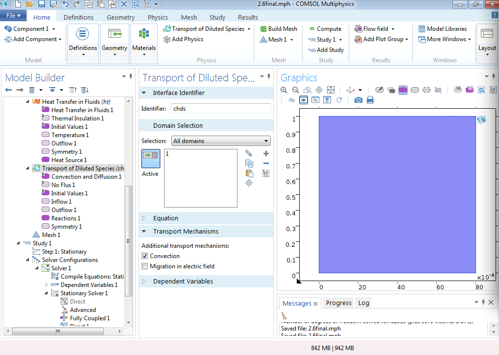

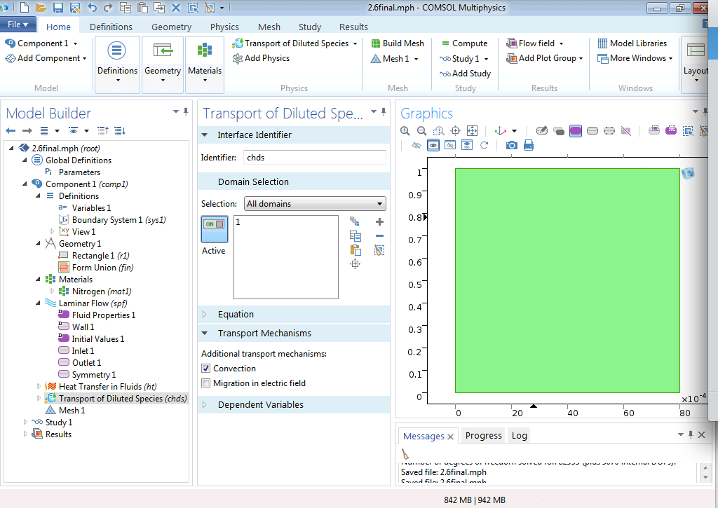

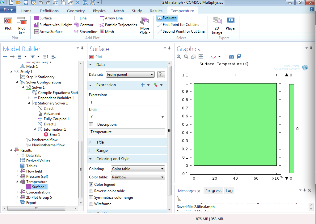

Undefined value found in the equation residual vector.
I am trying to model a pem fuel cell. Although I have entered all parameters and values, i have some errors as follows;
Undefined value found.
- Detail: Undefined value found in the equation residual vector.
There are 4 degrees of freedom giving NaN/Inf in the vector for the variable mod1.wH2Oc
at coordinates: (0.0022813,0), (0.0022432,0), (0.0022813,7e-005), (0.0022432,7e-005), ...
There are 4 degrees of freedom giving NaN/Inf in the vector for the variable mod1.wO2
Can you help me please?
