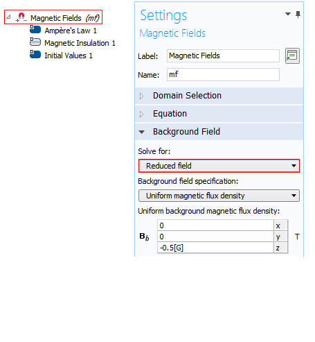

To impose external magnetic field, use Reduced field formulation in the magnetric fields physics, as shown in the attached image.
Sergei
