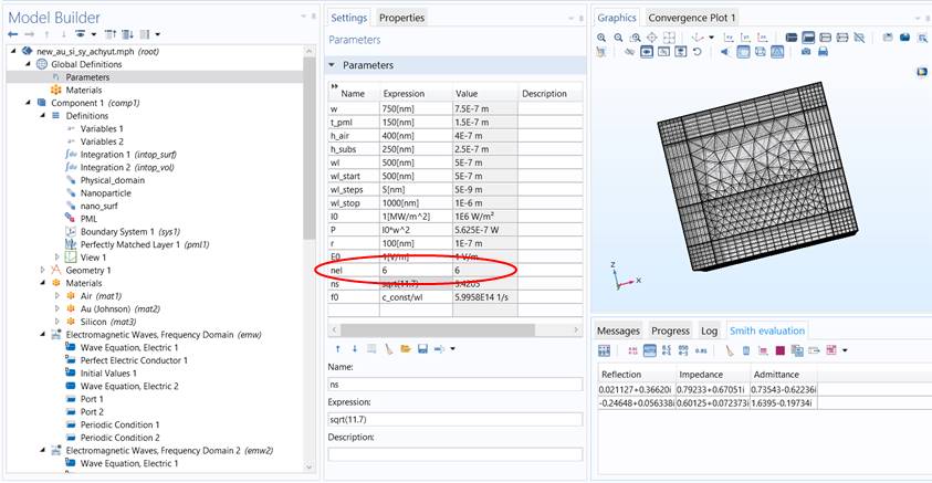

Dear Sergei Thanks a ton for your enormous help. It is running. But still I am not able to find the sacttering response from the sample. I think now I can solve it. But I have only a question regarding to the modelling that you have sent to me last week. actually you have defined a parameter namely, "nel=6" in the parameter section and then redefine the mesh size using this parameter. Can you please discuss what is the underlaying concept of taking this parameter? and how do you put the numerical value upto 6? It will help me lots. thank again for your continous support and help. With best regards Achyut
Achyut,
To resolve wavelength you have to have at least 5-6 second order elements per wavelength. Wavelength depends on frequency and local material properties. In your case, substrate has large refractive index (n=3.4), meaning that mesh in the substrate should have at least 6*3.4=20 elements per wavelength.
