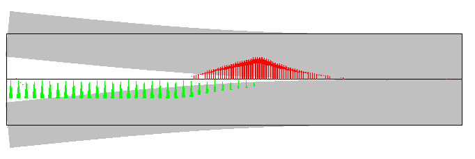

Hi Stefan,
I have uploaded a simple 2D model (version 4.3b) illustrating the principles of how a cohesive zone can be modeled in COMSOL Multiphysics. The model is not solved, but it only takes a minute or so to do it (and the animation during solving is nice).
Important features are:
- The expression in the thin elastic layer and the constitutive function it references.
- The extra weak expressions added for keeping track of the maximum opening experienced in a certain point. This is not necessary in a case where there is no unloading but then the constitutive relation would have to be written in a different (simpler) way too.
- The setup of the solver steps.
The uploaded plot shows the stress distribution (red) and a damage parameter (green).
The model is run under prescribed displacement. The reaction force plot shows why this is necessary. The released energy during cracking/delamination is so large that it would be unstable under a prescribed load.
Henrik

i learn carefully about the model you uploaded. I have a problem as following:
what the "umax" is ? is it a internal variable in comsol?
[QUOTE] Hi Andrew, I tried opening it in 4.4 and it works for me. It seems like some problem with your download then. If you cannot solve the problem, try asking support to send it. Regards, Henrik [/QUOTE] Hi Henrik, i learn carefully about the model you uploaded. I have a problem as following: what the "umax" is ? is it a internal variable in comsol?
Posted: 1 decade ago 2014/05/27 2:10 GMT-4
umax is a user defined field defined along the crack in Weak Contribution 1 -> Auxiliary Dependent Variable 1. It represents the largest opening that the crack was ever subjected to as a function of the position along the crack.
You can try adding a Line Graph along line 4 and plot umax. If you plot it for all parameter values you will see it growing. If you do it for parameter values 0.01 and upwards it has a constant distribution along the line, since that is the unloading phase.
Henrik
Hi, umax is a user defined field defined along the crack in Weak Contribution 1 -> Auxiliary Dependent Variable 1. It represents the largest opening that the crack was ever subjected to as a function of the position along the crack. You can try adding a Line Graph along line 4 and plot umax. If you plot it for all parameter values you will see it growing. If you do it for parameter values 0.01 and upwards it has a constant distribution along the line, since that is the unloading phase. Regards, Henrik

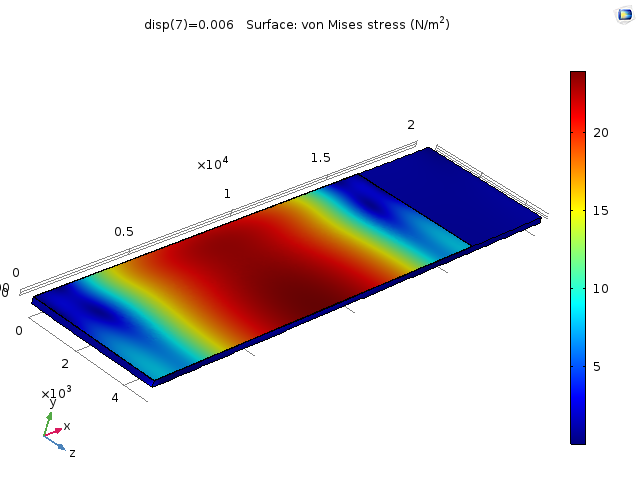

Hi for all,
sorry if my problem is far from Comsol, but the theme of discussion is important for my work.
I'm newcomer in the programation with Ansys, but I 'm working in contact problems, adhesion, so my main work is to deal a contact adhesif between Plan/Sphere to get out Force/displacement, note that both materials are gold.
Could someone can help me to solve numerically with ansys?, because analytically the problem is not easy, so,
any help in this regard would be welcome.

Posted: 9 years ago 2017/01/25 22:15 GMT-5
Hello Henrik.
How do I model decohesion due to moisture (drying effect).
I've worked on my model but the problem comes in defining a global equation to convert the hygroscopic forces into a displacement.
In this case I get stresses on the hyroscopic layer but there is no debonding.
Thank you.
Hello Henrik. How do I model decohesion due to moisture (drying effect). I've worked on my model but the problem comes in defining a global equation to convert the hygroscopic forces into a displacement. In this case I get stresses on the hyroscopic layer but there is no debonding. Thank you.
