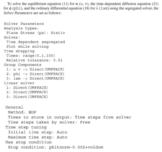

How can I access "Time-dependent Segregated" in the Solver of Comsol 5.2
I am solving a problem which has been solved using Comsol 3.5a with Comsol 5.2. There was "Time-dependent Segregated" in the Solver of Comsol 3.5a which was used when the problem was initially solved. But now, I cannot readily access "Time-dependent Segregated" in the Solver of Version 5.2. Please, how can I access "Time-dependent Segregated" in the Solver of Comsol 5.2? Please, find the attached description. Thank you so much.
