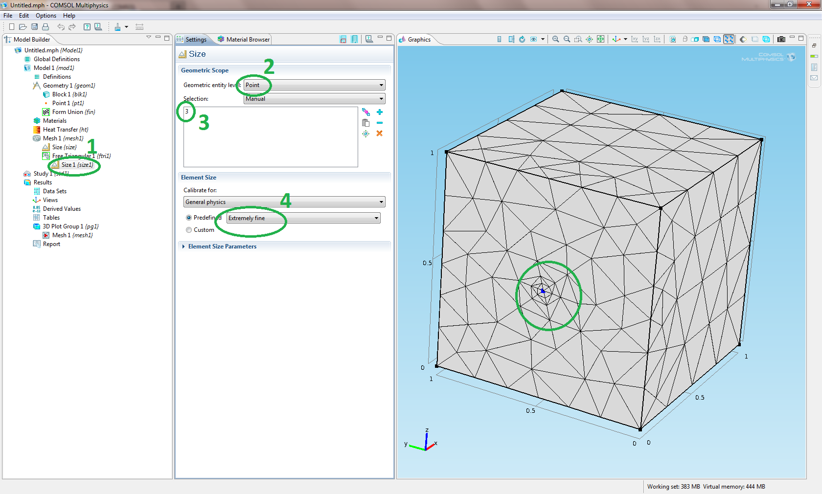

Refine mesh close to a point
Posted 2011/05/19 8:03 GMT-4 Mesh Version 4.1 2 Replies
                                                    Almost everything is in the subject: I have not found (yet) how to define the elements size in the vicinity of a point I have added inside the domain. Any idea welcome...
