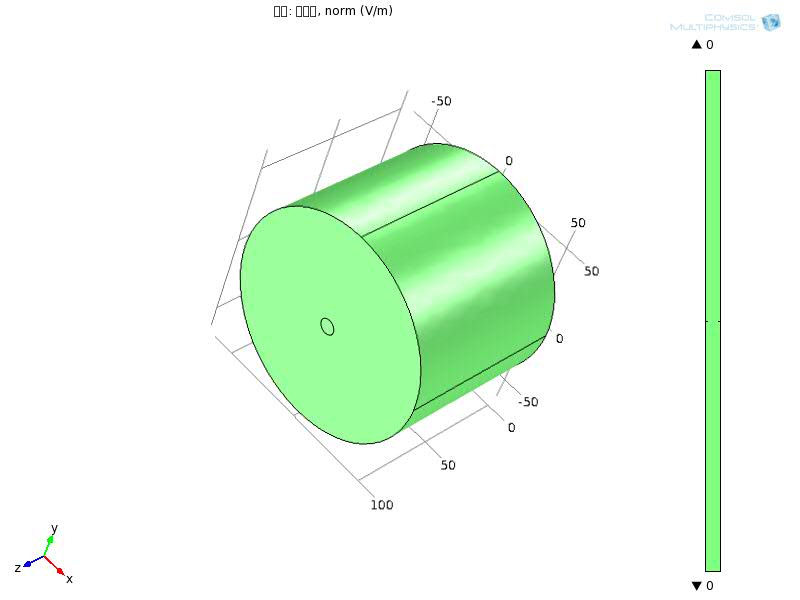

I am having a similar problem in optical fiber, did you solve the problem by any chance?
I think a lot still.
I set up the link of my thread and attach a jpg file.
www.comsol.com/community/forums/general/thread/22716/
and I attached a mph file(ver 4.0a) there.

I have a similar problem, but my waveguide stops after the entry to the port. if i disable the port and i am using the scattering boundary condition i have waveguide through the entire fiber but i can not establish the desired mode.

I thought that i had to use the boundary condition, too. But I attempted that, the result did not come out well.
If we select the Refractive Index in the Dispacement Field of the Wave Equation-Electric, because COMSOL processing algorithms solve the total reflection between core and clad of fiber internally, i think that we don't have to create the Scattering Boundary Condition.
Should we use the Perfectly Matched Layers by any chance?
(Even, I put some Electric Field directly into the core of the optical fiber. but it was also wrong to do that .)
However, I cannot assure. I would like to listen to a second opinion.
