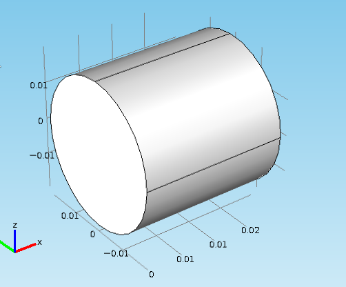

I am wondering if someone can tell me how to adjust the number of decimals displayed in the COMSOL GUI. In the attached picture, I am seeing 0,0.01,0.01,0.02 and I am guessing that it should really be 0,0.1,0.015,0.02.

have you checked all fields in the preferences ?
for "Tables" you have also a "full precision" toggle button on the Table GUI border
Hi have you checked all fields in the preferences ? for "Tables" you have also a "full precision" toggle button on the Table GUI border -- Good luck Ivar

Yes, all the fields in the preferences are checked. Also, from what I observed, the input display precision effects only the values in the input fields (eg: parameters) but I still can't change the precision of the numbers displayed in the GUI.

Any more ideas? I need to get this thing to work.
I am waiting for an upgrade to version 4.2 but I greatly appreciate it, if someone can test this and let me know what happens in version 4.2. Does this precision display problem still exist?

That was a bug in version 4.1 and it is fixed in version 4.2
