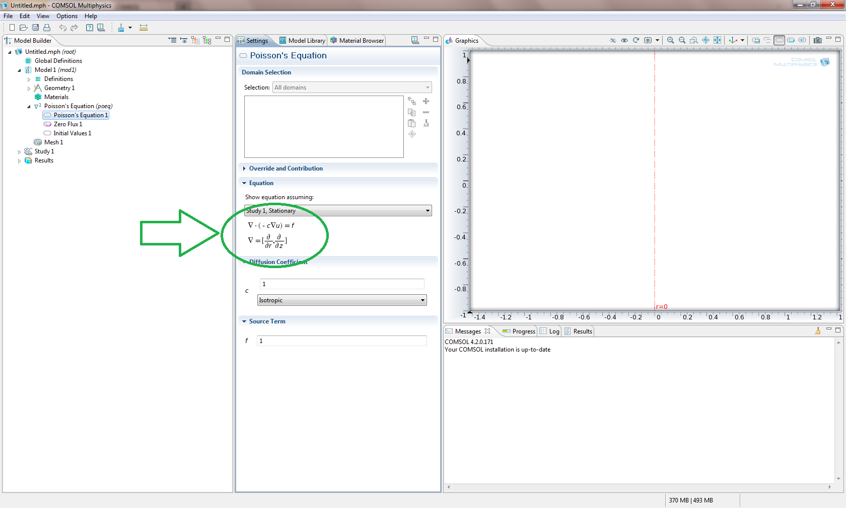

Posted: 1 decade ago 2011/06/10 18:14 JST
as a new user I am quite disappointed:
The geometry of the model can be defined as 2D axisymmetric, but when I add the PDE for Poissons equation to it (via PDE (poeq), the equation is not adapted to the geometry?
Which coordinate system is used in the equation? On the drawing/Geometry r and z is used, but it is not clear to me whether the equation is based on a cartesian system x,y,z , or on r,phi,z ?
How is the div (divergence) operator in cartesian and axisymmetric coordinates written in Comsol?
Thanks,
junis
Hello, as a new user I am quite disappointed: The geometry of the model can be defined as 2D axisymmetric, but when I add the PDE for Poissons equation to it (via PDE (poeq), the equation is not adapted to the geometry? Which coordinate system is used in the equation? On the drawing/Geometry r and z is used, but it is not clear to me whether the equation is based on a cartesian system x,y,z , or on r,phi,z ? How is the div (divergence) operator in cartesian and axisymmetric coordinates written in Comsol? Thanks, junis
Jeff Hiller COMSOL Employee
Posted: 1 decade ago 2011/06/10 23:15 JST
For Poisson in a 2D axisymmetric case, you can see the equation in the Equation section of the Settings window: it tells you that the software solves \nabla . ( c \nabla u) = f with \nabla defined as (d/dr ; d/dz ). See attached screenshot.

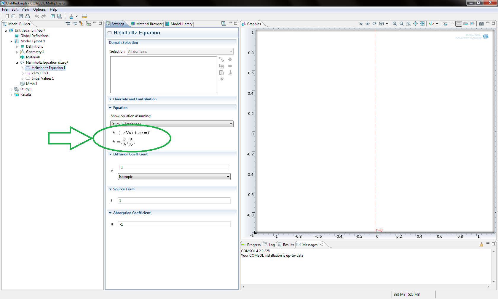

Posted: 1 decade ago 2011/09/07 19:15 JST
Hi there,
also as new user, who wasted several weeks now with on false 2D axisymmetric models, I must add that this is far more than dissapointing.
In my opinion it is by far not obvious for the common user that the program uses a different coordinate system internally than defined by the geometry. BTW: at least in the case of the Helmholtz equation the front end does not even show its internal definition of the nabla operator.
I must say, that I thought of comsol multiphysics as a really great piece of software. I mean, the front end, the live links to other programs and its huge spectrum of functionality are really convincing.
Now I must regretfully and painfully learn, that over quite some time all my calculations were complete nonsense.
It is totaly incomprehensible, why the mathematics models are not correctly implemented.
I strongly suggest to correct this flaw in future releases, because it is a completely unnecessary drawback of your otherwise fine software.
cheers,
jan
P.S: It is also not straight forward (at least for me) to manually correct for the missing terms.
Hi there, also as new user, who wasted several weeks now with on false 2D axisymmetric models, I must add that this is far more than dissapointing. In my opinion it is by far not obvious for the common user that the program uses a different coordinate system internally than defined by the geometry. BTW: at least in the case of the Helmholtz equation the front end does not even show its internal definition of the nabla operator. I must say, that I thought of comsol multiphysics as a really great piece of software. I mean, the front end, the live links to other programs and its huge spectrum of functionality are really convincing. Now I must regretfully and painfully learn, that over quite some time all my calculations were complete nonsense. It is totaly incomprehensible, why the mathematics models are not correctly implemented. I strongly suggest to correct this flaw in future releases, because it is a completely unnecessary drawback of your otherwise fine software. cheers, jan P.S: It is also not straight forward (at least for me) to manually correct for the missing terms.
Posted: 1 decade ago 2011/09/07 22:25 JST
Hello Jan-Henrik,
I suspect you are running an outdated version of the software. In the current version, the definition of \nabla is displayed when solving the Helmholtz equation using the Mathematics interface; see attached screenshot.
Hello Jan-Henrik, I suspect you are running an outdated version of the software. In the current version, the definition of \nabla is displayed when solving the Helmholtz equation using the Mathematics interface; see attached screenshot. Jeff
Posted: 1 decade ago 2011/09/08 2:08 JST
thanks. I was running 4.1, which indeed does not come about with this helpful hint.
In the meantime I figured out how to compensate for the missing stuff. Just in case anybody else faces a similar problem...
If your diffusion coefficient c is isotropic, you just muliply *all* coefficients (c,f and a) by r. Thats it.
And voila, it produces the same result as a true 3D calculation.
I don't know what happens if the diffusivity is not isotropic.
greetings,
jan
Hi, thanks. I was running 4.1, which indeed does not come about with this helpful hint. In the meantime I figured out how to compensate for the missing stuff. Just in case anybody else faces a similar problem... If your diffusion coefficient c is isotropic, you just muliply *all* coefficients (c,f and a) by r. Thats it. And voila, it produces the same result as a true 3D calculation. I don't know what happens if the diffusivity is not isotropic. greetings, jan
Posted: 1 decade ago 2011/09/08 7:05 JST
r or 2*pi*r ? ;)
Hi r or 2*pi*r ? ;) -- Good luck Ivar
Posted: 1 decade ago 2011/09/09 22:55 JST
Hm, I compared normalized results...
Maybe you're right with the 2*pi...
But why should there be a factor 2*pi?
I mean, comsol uses nabla =[dr, dz] so the first term operator of the Helmholtz equation looks like
[dr, dz]*(c*[dr,dz])
where c =[c11,0;0,c22] is a diagonal matrix in the isotropic case (dr and dz denote the derivation with respect to r and z).
This is the equal to
dr*(c11*dr) + dz*(c22*dz)
But I really want is
1/r*dr*(r*c11*dr) + dz*(c22*dz)
So in the first step I multiply the whole eqation by r and the above becomes
dr*(r*c11*dr) + dz*(r*c22*dz)
Hence, c has to become r*c.
Did I miss anything?
jan
Hm, I compared normalized results... Maybe you're right with the 2*pi... But why should there be a factor 2*pi? I mean, comsol uses nabla =[dr, dz] so the first term operator of the Helmholtz equation looks like [dr, dz]*(c*[dr,dz]) where c =[c11,0;0,c22] is a diagonal matrix in the isotropic case (dr and dz denote the derivation with respect to r and z). This is the equal to dr*(c11*dr) + dz*(c22*dz) But I really want is 1/r*dr*(r*c11*dr) + dz*(c22*dz) So in the first step I multiply the whole eqation by r and the above becomes dr*(r*c11*dr) + dz*(r*c22*dz) Hence, c has to become r*c. Did I miss anything? jan
Posted: 1 decade ago 2011/09/10 18:22 JST
You have probably not missed anything
my 2*pi*r was mainly ment as a reminder, as it's the most common error when integrating in 2D-axi, when one integrate over an edge and desire the area which menas one should not forget hte "2*pi*r*dr" instead of the cartesian "dx*dy"
The same for the development of the 2D-axi variables, to avoid the singularity at r=0, but then it's mostly "r" as the 2*pi* appear twice and simplifies
Hi You have probably not missed anything , my 2*pi*r was mainly ment as a reminder, as it's the most common error when integrating in 2D-axi, when one integrate over an edge and desire the area which menas one should not forget hte "2*pi*r*dr" instead of the cartesian "dx*dy" The same for the development of the 2D-axi variables, to avoid the singularity at r=0, but then it's mostly "r" as the 2*pi* appear twice and simplifies -- Good luck Ivar

This is not complete information. In cylindrical coordinate system
d/dtheta (er) = etheta
so etheta*d/detheta (er) = 1
If \nabla defined as (d/dr ; d/dz ) then we will miss a term in an axisymmetric system when calculating \nabla . ( c \nabla u) = f
for c=1 it should be: d^2/dr^2 (u)+ (1/r)d/dr (u)+ d^2/dz^2 (u)
and not this: d^2/dr^2 (u) + d^2/dz^2 (u)
Can you please clarify on this...
Note: er, etheta and ez are unit vectors in the respective direction.
