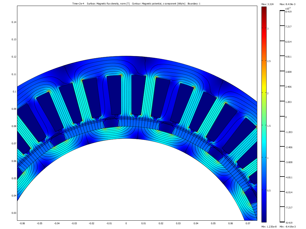

Attila and I worked together on this project in the past, however, I will carry on this work alone in the future. Meanwhile we decided to use the full model beacuse we experienced differences in the magnetic field when using a sector only compared to the full motor. Also, I have found a very usable HB curve for our material (M19 steel) so I get now a good looking magnetic field. (When experimenting with sector antisymmetry we started from the library model 'generator sector dynamic' in COMSOL 3.4 and set boundary conditions accordingly.)
I think Attila wrote about stationary calculations (describing as 1D) when we tried to calculate torque that we could not do accurately in transient simulation incorporating an ODE for the dynamics.

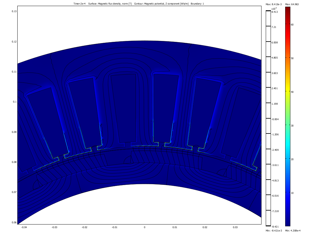

As now having acceptable magnetic flux densities my next step is to couple the model with heat ttransfer and get a temperature distribution caused by resistive heating. For this I have to specify conductivity. Doing so my results become unusable having increasing flux densities with time. I attach hardcopies with sigma=2e6 [S/m] and with sigma=0 [S/m] for the rotor/stator. My mesh is believed to be fine enough and I used tolerances of 1e-5 for 'A'.
Resistive heating works, I have increasing temeratures, however, adding Sigma to the material ruines my magnetic field. (I expect flux densities around 2 [T] instead of 64 [T]).
I see that you also implemented conductivity in your model. Did you faced the same problem? How did you solve it?
(I use mainly COMSOL 3.4 but I've built the same model also in 4.2 and got the same bad results.)
