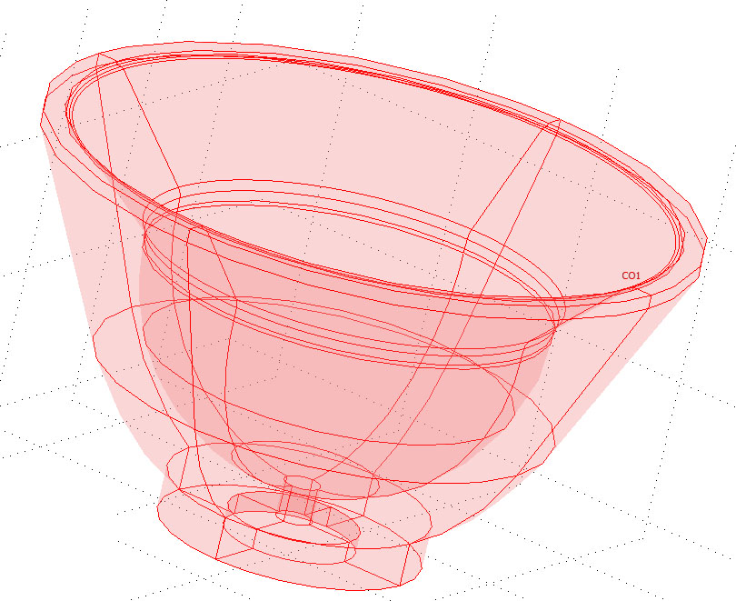

thanks a lot for your help. I hope i can use your ways to get a solution. But my geometry is not such a hollow sphere but rather a half open hollow sphere. Do you think it is possible to use some of your ideas anyway? And i need the the solution/modelling implicitly in 3d. enclosed i have attached a picture of the geometry i think it helps you.

Hi Ivar, thanks a lot for your help. I hope i can use your ways to get a solution. But my geometry is not such a hollow sphere but rather a half open hollow sphere. Do you think it is possible to use some of your ideas anyway? And i need the the solution/modelling implicitly in 3d. enclosed i have attached a picture of the geometry i think it helps you. thanks a lot for your time and help stephan

Your geometry is really nice and symmetrical, so why not use just one quandrant, or even a smaller part, you gain in nodes and elements hence calculation speed.This implies that the oterh BC (boudary conditions are symmetric).
One caveate with symmetry is modal structural analysis, as you will have to consider symmetric and anti-symmetric BC, and you must treat thease as separate cases and add the eigenfrequency lists by hand, requireing several simulations and some care to recombine the shapes
So you need to adapt slightly my previous formulas, and I would work in 3D cartesian space, but even you could use 2D axisymmetry (again depends on your loads or other external BC's).
Unfortunately COMSOL has no simple "projection" operator to cut a 3D volume and project directly the shape of its section into the 2D axisymmetric plane, a pity (but COMSOL does have a powerfull 2D axisymmetry "revolve" geometry function, but only this way, IF SOMONE OUT THERE HAS MADE A PROJECTION SCRIPT PLS POST IT to help us others too ;)
in any case the local deformation remains u,v,w so when you integrate this over the area (or its square u^2+v^2+w^2 you get the deformation or dr^2, when normalised over the area its the RMS deformation.
Pls check carefully the units as you must normalise over the area, the implicit integration of the "integration coupling variables", or the "postprocessing integrations" are sometime misleading if their meaning is not crystal clear in your mind
Always check your results against a simple hand calculation
