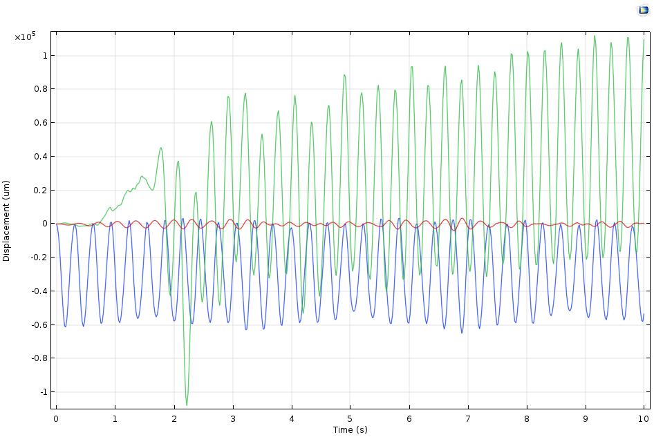

I am fairly new to COMSOL & my objective is to study the response of various structures to induced earthquake motion. I have managed to produce a set of results showcasing the pressure and shear waves travelling beneath the surface as a result of the shaking.
Please find attached the Displacement/Time Graph obtained from the displacement of a point 10m below ground of a 3 storey concrete building. (w, u, v components)
However, I wish to now find out the time period, average time period and wavelength of the resulting waves. Is there a function, operation or way I can plot this from the information I have obtained?
I would greatly appreciate any help!
Thank you, MM
