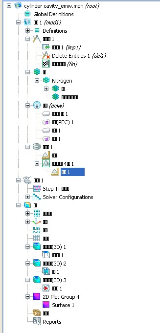

I used the physics setting listed as below
*Module:'Electromagnetic Wave(emw)'
*I use 2.45GHz TE10 mode microwave as 'Port'
*Displacement Field:'Relative permittivity'
*Why do 'h_bend_waveguide_2d/3d'?models use 'refractive index' as the 'displacement field'?
*Study:'Frequency Domain'
*I can not use other frequencies except 2.45GHz in the experiment equipment
to simulate a Nitrogen-filled cylindrical cavity's electromagnetic field distribution.
I am not familiar with the physical properties value of the nitrogen and stainless-steel boundary of the cavity.
I just input some simple value into the model I set up. For example,
* Electric conductivity = 0.24
* Relative permittivity = 1.0 for Nitrogen
* Relative permeability = 1.0 for Nitrogen
Maybe I missed the setting of the boundary condition for the stainless steel cavity.(I don't know how to do it or do it appropriately.)
I ran the model and only got zero electrical field distribution inside the cavity( the electrical field is non-zero only at
the input of the regular hexahedron). Why? Can you help me out with this? Many thanks!!!!
Model description:
*a large cylinder cavity A (boundary material:stainless steel, filled with Nitrogen gas)
*a small cylinder B (located in the center of the cavity A, material:stainless steel,
it will hold some material to be heated, the height of cylinder B can be changed )
*a regular hexahedron (2.45GHz TE10 mode microwave will be input at the end of it, acting as wave guide)
I attach the model file 'cylinder cavity_emw.mph' with this post. Many thanks for your generous advise!

Try setting the conductivity to 0. I don't think that nitrogen is conductive at all. When I did this I was able to see results in the Efield plots.
Also, your mesh is set up a little confusingly. Underneath the free tet you have, you added another global condition which is not really helping you that much. I would tell you that you do not need that size feature. I would suggest adding another size feature right below the global one. See my file attached. I added more mesh elements to the port BC. Reason is that if you try and calculate s-parameters you want the port meshed finer. You may have to make it finer than what I have as well.
Your version of s/w is in another language, as I get gibberish when I read the file. I am able to figure out what you did but it would be confusing to a new to COMSOL person.
I hope none of this leads you astray.

Dennis, Many thanks for your response and advise.
I used the Japanese version when I set up this model.
Now I changed the language into English and changed the conductivity of the Nitrogen(yes, it should not be 0).
I referenced the mesh setting in the user guide.
I am totally green with COMSOL and trying to learn it.

Lets start with the meshing part. When you first add a free tet node to a model, you will get two nodes that come up. One is a size node and one is the free tet node. The first size node controls the overall mesh fineness/density. The first free tet node will apply to the the whole geometry unless you change it. You can have multiple free tet nodes in a simulation but that would be a case where you have several domains or areas where you are meshing them separately.
In your case since the overall geometry is simple, you can just use one free tet for the whole geometry. With that said, if you allow the program to mesh with just those two nodes, you will get a mesh density controlled by the first size node. What you did in your model was that you added a second size node underneath the first free tet. In that size node, you allowed it to control the entire geometry. What this means is that you have that first size node controlling the entire geometry and second size node underneath the free tet node controlling the geometry and they appear to be kind of fighting each other. What happens is that the first size node wins out. You did not see an error with meshing because the program was able to do so but it also did not tell you why you were doing it less efficiently. With the way you sent the model, the number of mesh elements shown by COMSOL is 9925. If I disable the size node underneath the free tet node, I then get 9998. The nodes are fighting each other and not improving your mesh. When I posted my first file, I had changed the size node underneath the tet node to be a boundary only, specifically where you had the port for applying RF. In general, when you apply extra size nodes below a free tet node, you are looking to make a particular domain/boundary/edge have a finer or coarser mesh than what the overall mesh will be. Do you understand this?
Meshing is not as simple as it appears. You only get better at it when you do it a lot. You need to work several examples and maybe take some classes that COMSOL offers.
As far as the actual simulation goes, you will need to find out what the conductivity of Nitrogen really is. When I had conductivity set to 0, there were fields present in the output plots. When it goes slightly above 0, the fields change and decrease. I have not taken them time to really look into the problem as I can't spend the time at the moment. I don't think Nitrogen would be very conductive. Since it is in our atmosphere, it is a good insulator so I would expect the conductivity to be low. Maybe somebody else reading this has more insight. I think your problem is set up right but there may be finer details that I do not know about. If I get a moment to really look at this, I will but maybe others can help out.
BTW, what is it that you are trying to do here? Are you trying to measure input impedance of your structure? Determine return loss? Other?
