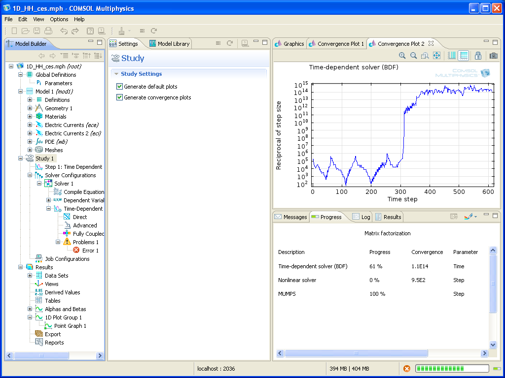

I have the same general symptoms as above: Time-Dependent solution proceeds fine for some time. Then, all of a sudden, the "Reciprocal of step size" on the convergence plot goes to 10^14 and stays there. (See attached convergence plot.)

• Sometimes, after thousands of time steps all around 10^14 it says "The following feature has encountered a problem: Repeated error test failures. May have reached a singularity. Time: .... Last time step is not converged. - Feature: Time-Dependent Solver 1 (sol1/t1)"
• Changing the BDF time-stepping to Strict and decreasing the maximum step size arbitrarily, still leads to this error.
• The behaviour of trying to terminate the process (as it's obviously not making much progress towards terminating, if it goes in time steps of length 10^-14) is (whether I press the round red button with a white cross on the status bar, OR use the Stop buttons on the Progress tab) that the convergence plot accelerates (!) and so does the activity in the Progress tab, while CPU activity goes to zero on all but one CPUs. I'm interpreting this as a bug where it's trying to process results coming in from the server after I cancelled the simulation i.e. I don't need the results.
• See the convergence plot attached.
Note that, as with the others, the simulation runs acceptably for about 100 ms. I am simulating neurons, and the neuron spikes a couple of times, and everything is fine. Suddenly we see this problem. It's not related to any features of the dependent variables or their gradients — it happens away from sharp transitions in any of them, as I can see if I plot "Results While Solving".
My question is: how can I find out which of the dependent variables (I have 4) fails the error test (which is what must be driving the time step to very small)?

This affects only the BDF solver. Switching to Generalised Alpha avoids the problem behaviour.
I came to the same conclusion as Evgeni. I ended up using Manual Generalized Alpha time stepping and defined my specific time steps. This solved my problem without convergence errors. Hope this helps others.
