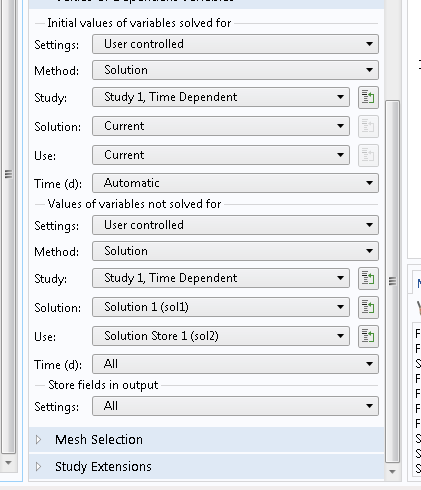

                                                    Hello Asal,
What variables you choose to store in the output does not affect the equations that are solved. In particular, not storing the velocity vector will not make it a pure conduction problem.
So if the solution of your model appears to reflect pure conduction, it is likely that you did not specify the velocity field correctly for the convective term (That's happened to me a couple of times:) ), or that the convective effects in this particular problem are so small that their impact on the solution are drowned out by the conduction.

                                                    Dear Jeff,
Many thanks. So I attached my initial values set up for second sub-study (T). what you are saying is that even with this arrangement, I can still uncheck the v,p in the store solutions?
Regards, Asal
