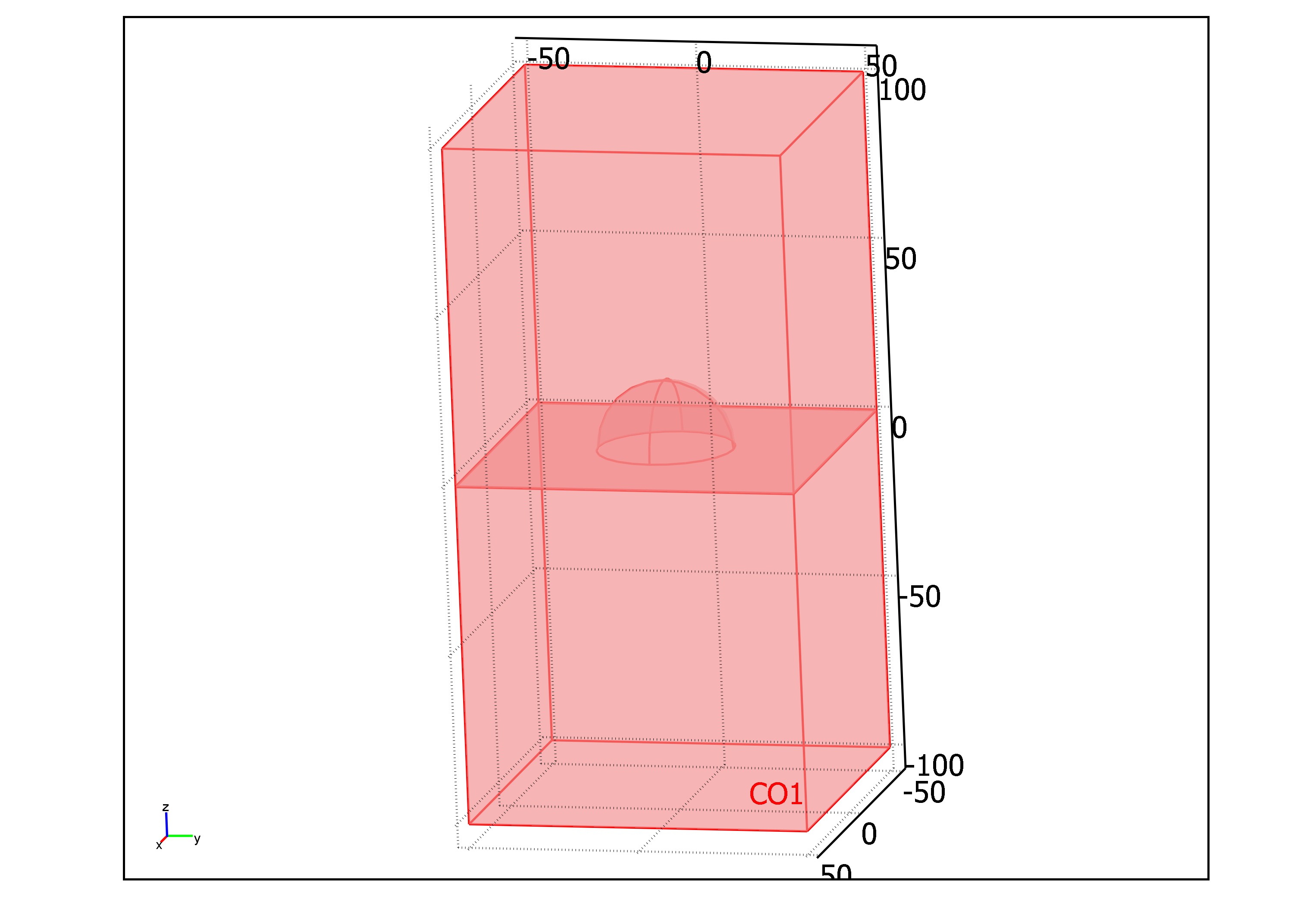

                                                    Hi, K.P.
Thank you for your reply.
As you mentioned, it is true that I can mesh the interface between two objects, but, the interface belongs to the thin plate will definitely has a hole, and it did not work when I try to use the "swept mesh".
Currently, my solution comes from a poster here named "mesh a thin plate" or something similar.
I divided the thin plate into at least two pieces-- a plate with a central hole and a central part whose surface is exactly equal to the bottom of the hemisphere. In this case , I can use the Swept mesh with no problem.
But, I made the central part by extruding the 2D circle, and I found the edge of circle is not consistent with the edge of 3D shpere well, or I should say rather rough.
These un-matched interface will lead to the inverted mesh element at their edge and a warning accured after all the calculation.
Does anyone meet the rough 2D problem before?

                                Ivar KJELBERG
                                                Posted:
                                2 decades ago
                                2009/12/26 7:25 GMT-5
When I see your jpg, my first question is cannt you transform these cubes into cylinders?, so that you can use 2D-axi and get rif on one DoF.
If not, then I would split the parts into 4 symmetric items, using the split lines of the hemisphere. there are then 2 ways out.
Either the case is symmetric so one can work with symmetric/anti-symmetric boundaries and mesh only 1/4 of the problem.
Or, to work in full 3D. By having split the volumes, it is easier to apply a sweep mesh.
By the way a sweep mesh can be defined manually from ONE or SEVERAL starting surface(s), but then ending on only ONE opposed surfaces, allowing a simple projetion. I agree there are severe limitations in the topology to get it meshing by the sweep function, some excercices are often required.
