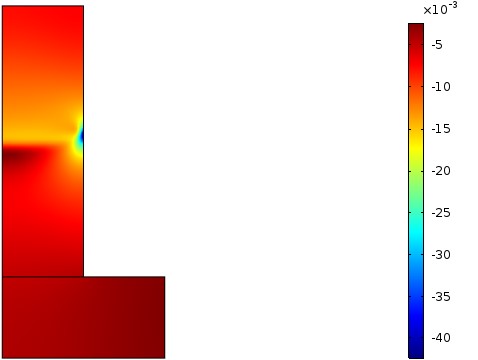

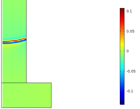

I have a question regarding the Capillary Filling – Phase Field Method (https://www.comsol.com/model/capillary-filling-8212-phase-field-method-1878).
I noticed that when I plot the variable psi (chemical potential) the result is different when I plot the equal quantity of psi which is ” -pf.epsilon_pf^2(phipfrr + phipfzz + 1/rphipfr) + phipf*(phipf^2 – 1)”. Why does that happen?
Of course the correct chemical potential is equal_of_psi.jpg.
