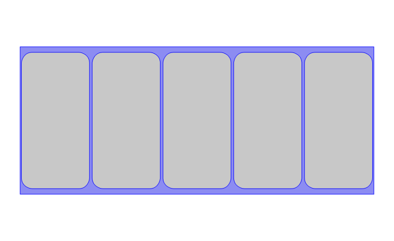

                                                    Hi Niklas,
Thank you very much for your reply. I tried the General Projection on a simple rectangular domain but still have trouble getting the correct solution. The model file is attached and the model problem is described as follows.
Molecules undergo diffusion (with rate D2) and degradation (with rate kdl) in a rectangle, where the concentration of the molecule on the left boundary is fixed at c_max. When I solve the system using Time Dependent study, it works fine. But the stationary study gives oscillatory negative values, which I don't quite understand. I wonder if you have any idea what is wrong here? Thank you very much.
Emily

Steady-state has a closed form solution
c/c_max = cosh[lambda·L(z-1)]/cosh[lambda·L]
where z = x/L, lambda² = kdl/D2 and L = the length of the domain (50 m).
As you see, the problem is in 1-D, really. I also was pondering the dimensions of the simulation domain (50 m) but then realised that your diffusion coefficient was 0.1 m²/s, making lambda·L ≈ 1.58. Did you think of making the problem dimensionless?
I also got an oscillatory steady-state :)

                                                    Aargh!
The reaction term must be of course -kdl*c. The  it works fine

                                                    Thank you Lasse! Yes, the reaction term should be -kdl*c. That's a stupid mistake.
