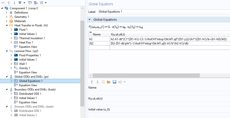

Hi, Jeff, I found out I still couldn't get my boundary condition updated correctly for each time step. Here's my model: (not as complecate as it may look like)

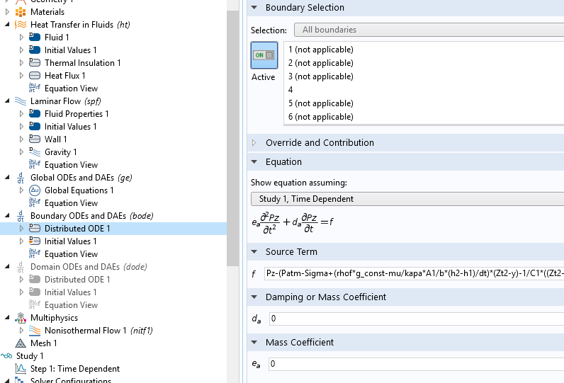

At each time step, Comsol solve the nitf1 (laminar flow, heat transfer model). I define heat flux as my boundary condition. I use Global ODEs and DAEs to calculate one value h2, it's related to h1 and intop1(heat flux), and also value Z2, related to Z1, h2,h1 and intop1(heat flux) all good so far. I also need to calculate Pz, related to h2,h1,Z2,Z1, intop1(heat flux), and y coordinate, Pz is used to update my boundary condition for the next time step. I use Boundary ODEs and DAEs to define it.
Here's my problem: 1.How can I use Pz to update my boundary condition for the next time step, but not affect the boundary condition for this time step? 2. My 2nd goal is to store h2 and Z2 for every time step, but how can I update h2? I want to make it like h2=........, h1=h2, then use new h1 for next step, but I don't know how to make it work in Comsol.
