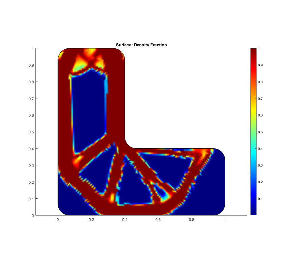

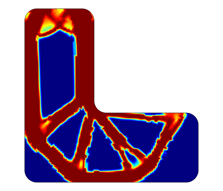

Hi Lars,
Thanks for your reply. I have attached two pngs, one through mphplot from Matlab, and the other one directly from Comsol Multiphysics. You can see the difference in the resolution of the image, it feels like mphplot dilutes the data before sending it to Matlab. Your input is highly appreciated.
Thanks, Mohamed Abdelhamid

Hi Mohamed
Try this: mphplot(model, 'pg2', 'indexedcolors', 'on')
Note: The indexedcolors property is experimental, undocumented and unsupported. It may disappear in a future release of Comsol.
