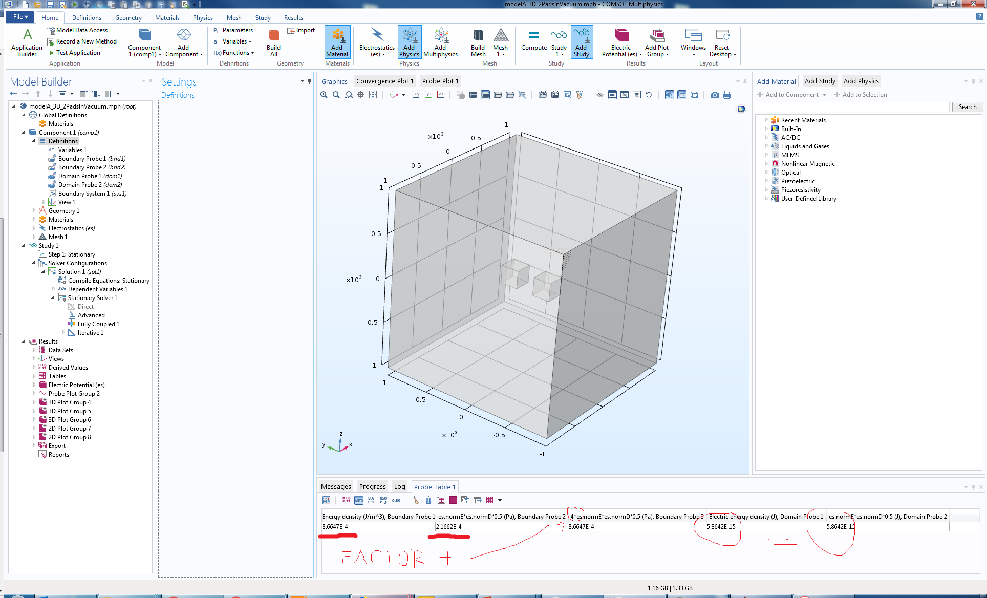

The problem is that I am geting diferent numbers when integrating over the energy density (es.We) compared to integrating over (es.normE* es.normD* 0.5), which should be the same by definition. The difference is exactly factor of 4 (integral over esWe is bigger)!

The problem seems to be even deeper. The factor of 4 appears already when exporting the values of the energy density calculated by different expressions (see attachment).
Any help?
The problem seems to be even deeper. The factor of 4 appears already when exporting the values of the energy density calculated by different expressions (see attachment). Any help?
