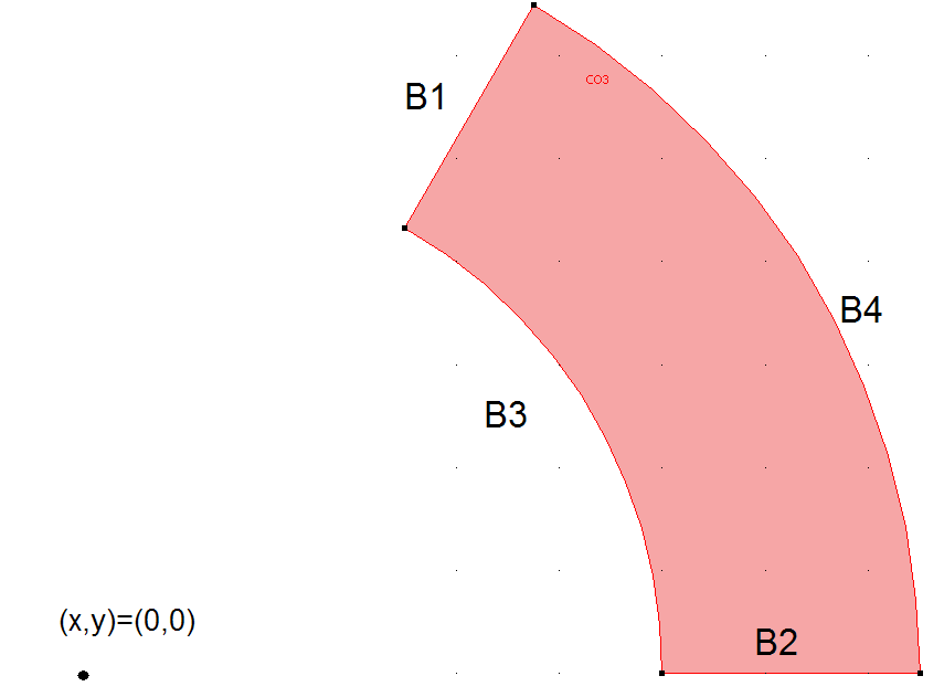

In my 2D cylindrical structural mechanics model, I am going to simulate almost a quarter of a rubber-like (hyperelastic) material tube (please see the attached picture) and stretch it circumferentially to make it a half tube. I have successfully done this in Cartesian coordinate, however, I prefer to do that in cylindrical system too.
In my V4.2 COMSOL, I have defined a cylindrical coordinate system, but I have problem correctly defining the boundary conditions. In the boundary condition menu, first I selected the Cylindrical coordinate system. For boundary # 3, the displacement in r-direction should be “r-R”, where r is the final radius (unknown) and R is initial radius, which is known. Of course I enter “sys2.r – R” as my Cyl. Coord. Sys. is sys2.
