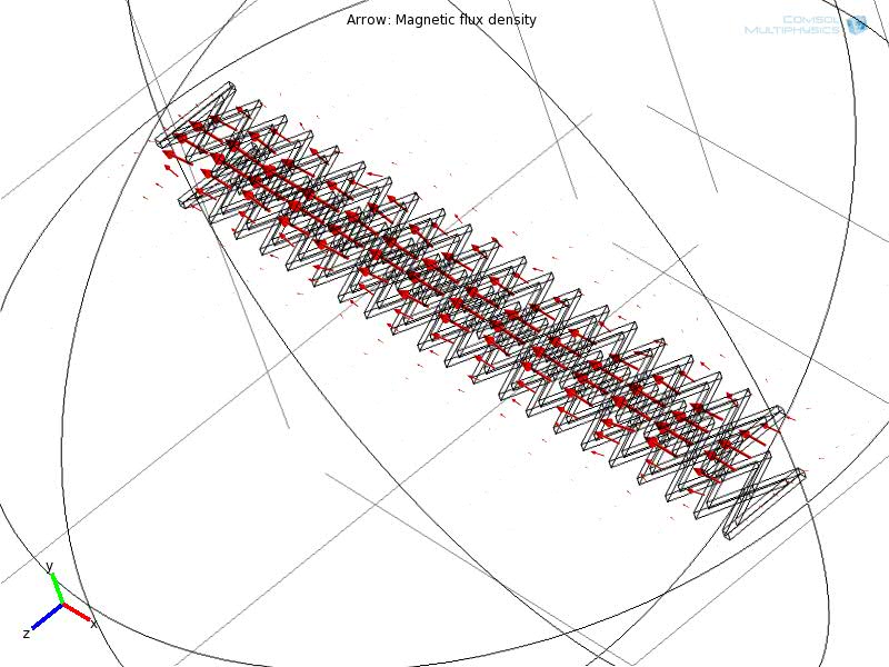

In the picture which is attached, I plotted arrow volume under 3D plot group.
What I need is the output of a value of the magnetic field [B] between the wires,
I think that is anyway what is already plotted in my simulations.
I have found the value of the magnetic field in the wires but not between them.

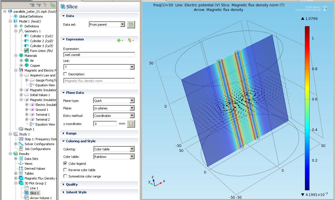

Do you want something like the attached image?
This is a slice in a 3D plot group.
Ralf
Hi Marta! Do you want something like the attached image? This is a slice in a 3D plot group. Ralf
Posted: 1 decade ago 2011/08/08 4:44 GMT-4
Hi Ralf!
Thanks for your response.
What I want is the value (the magnitude) of the magnetic field between wires.
I need a table with those values, not a plot.
Many thanks,
Marta.
Hi Ralf! Thanks for your response. What I want is the value (the magnitude) of the magnetic field between wires. I need a table with those values, not a plot. Many thanks, Marta.
