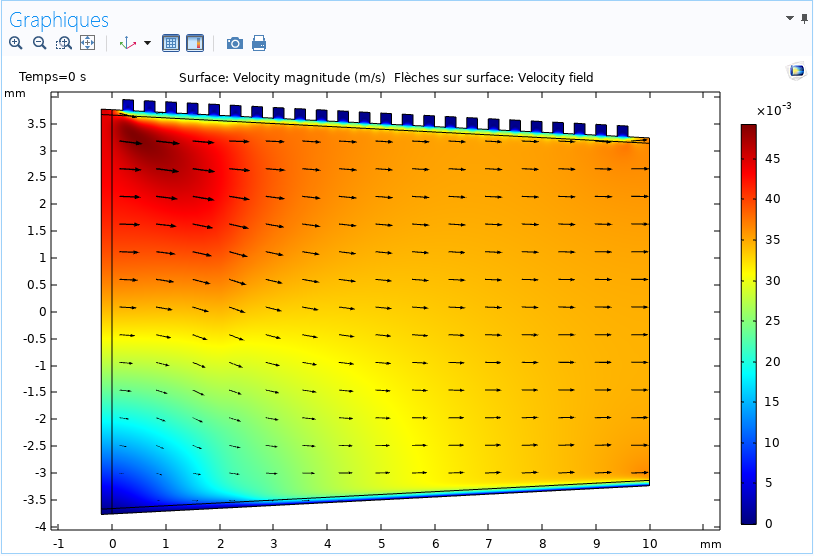

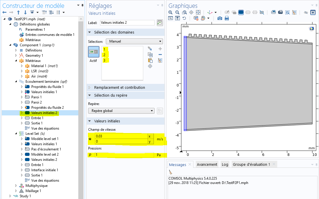

I hope everything's well for you ! I am fairly new to COMSOL and I am performing a CFD simulation with laminar flow and biphasic flow with level set method. As I am studying the filling of my geometry, I use a time dependant study.

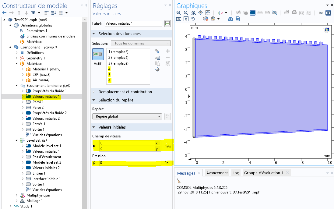

I am facing an issue with the simulation : - I assigned a first step of initial value in my first domain with my material that will fill the cavity (u = 3mm/s et a pressure at 1) - I assigned a second step of initial value for the air present in the cavity where nothing happens at time t=0s (everything is at 0)
However in my results, it seems that only the initial values of my first domain are taken into account in all the geometry, and I cannot really understand why. Has anybody faced the same issue and can maybe give me some advice on this ?

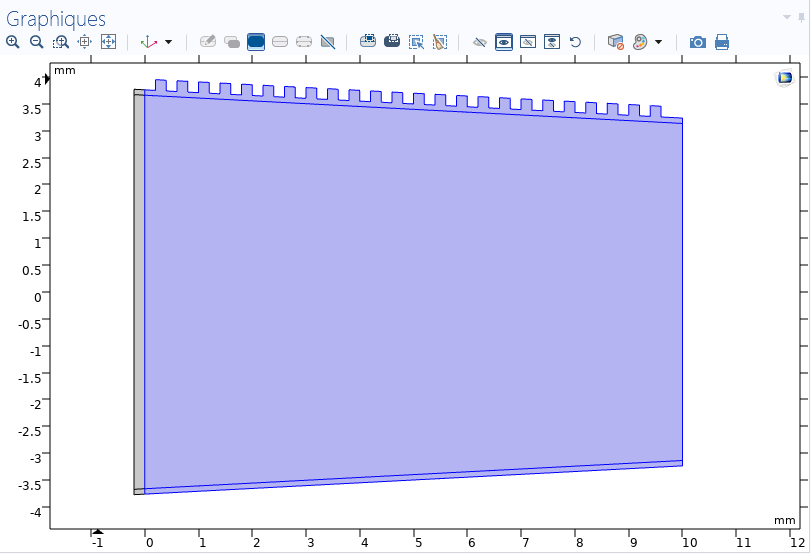

I hope I have been clear enough ! Here are some photos of my geometry : - The first one shows the speed at time t=0s where I think I should see no speed in he second domain - The second one is to show the two domain I am working with Thanks in advance for your help !

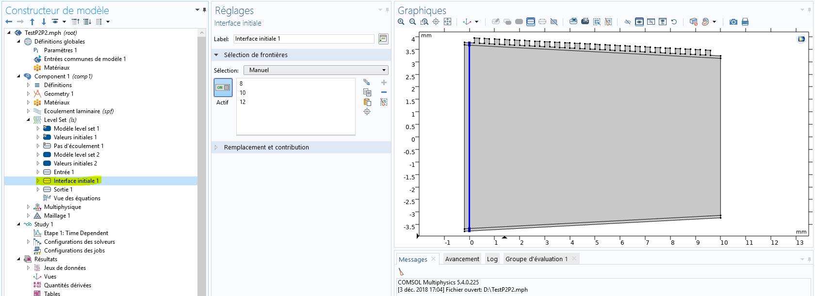

Hello Mr Rembe,
Thanks a lot for your answer ! I took a little bit of time to answer back because i was trying to do what you told me.
First off i will try to clarify my issue :

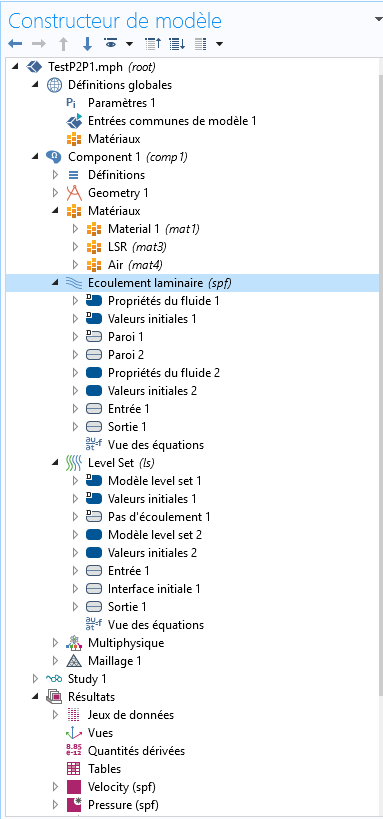

I put some photos to illustrate the method and the different steps I used for the laminar flow part of the study, i hope it will be clearer. It is in french but i will put the translation here :

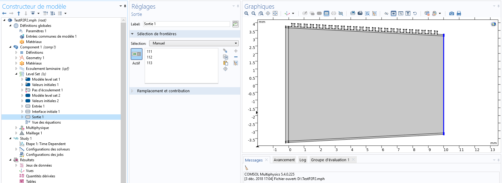

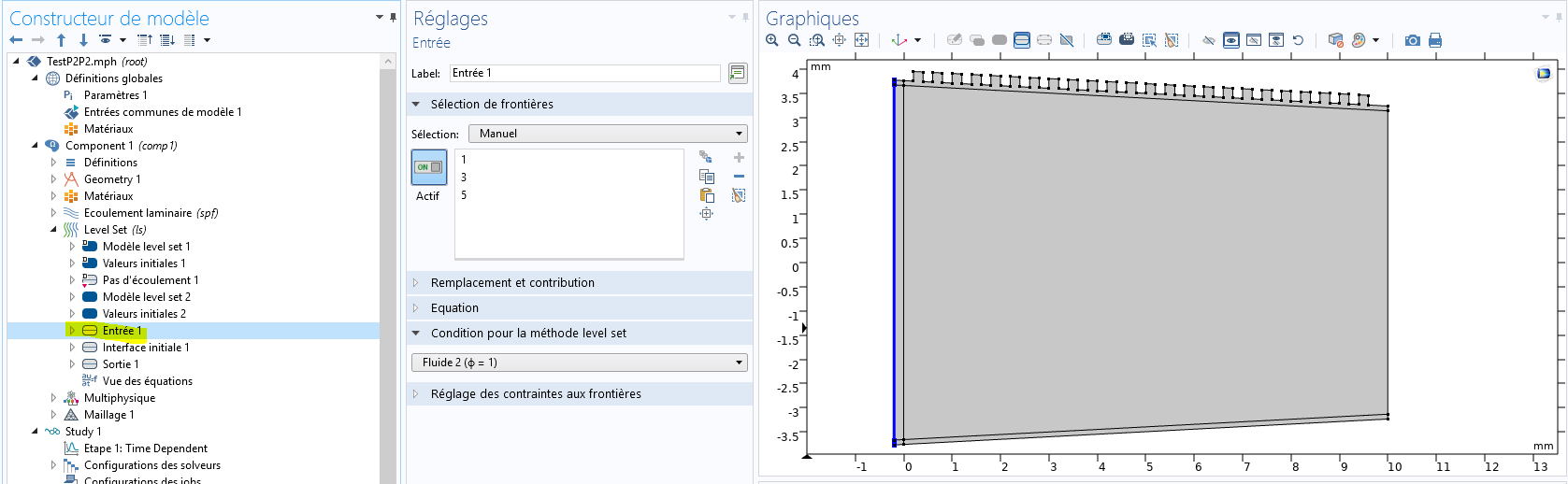

(see forumComsol3.png) Laminar flow (spf) - Fluid properties 1 - Initial values 1 (see forumComsol4.png) - Wall 1 - Wall 2 - Fluid properties 2 - Initial values 2 (see forumComsol5.png) - Inlet (see forumComsol6.png) - Outlet (see forumComsol8.png)
Level set (ls) - Level set model 1 - Initial values 1 - No flow 1 - Level set model 2 - Initial values 2 - Inlet (see forumComsol6.png) - Initial interface (see forumComsol7.png) - Outlet (see forumComsol8.png)
So my initial values 1 has the velocity u = 0 m/s and the pressure p = 0 Pa, and my initial values 2 has the velocity u = 0.03 m/s, and the pressure p = 1 Pa. This is what I meant when I talked about steps. I thought that it would be logical to have a speed equal to zero in the bigger domain since I have initial values at 0 in it, however the results seem to show that I have a speed near 0.03 m/s in all of the geometry at time t=0s (see forumComsol.png). So this is my issue.
I tried to set the "values of independant variables" correctly as you told me, but my firt trials are not successful for the moment.
Thanks again for your help! I you've got any more ideas or advice to give me I am fully open to it :)
