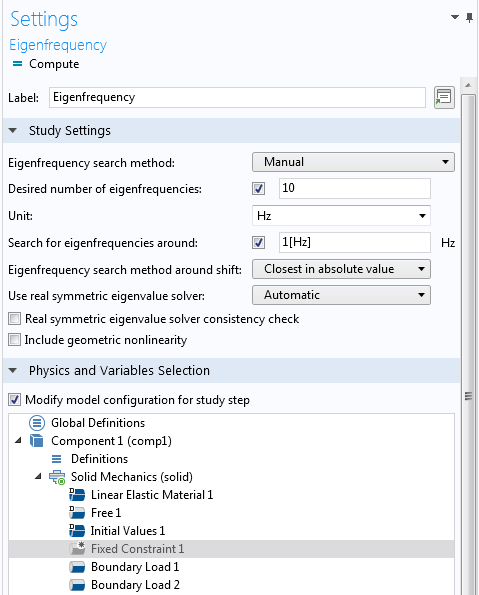

This seems like a case where selecting the Modify model configuration for study step check box would be useful (in the Settings window for the Eigenfrequency study step, for example). You then get a copy of the physics part of the model tree, where you can right-click nodes to disable them for that study step (see the attached screenshot for an example, where a Fixed Constraint has been disabled for the eigenfrequency study).

Hi Dan, This seems like a case where selecting the **Modify model configuration for study step** check box would be useful (in the Settings window for the Eigenfrequency study step, for example). You then get a copy of the physics part of the model tree, where you can right-click nodes to disable them for that study step (see the attached screenshot for an example, where a Fixed Constraint has been disabled for the eigenfrequency study). Best regards, Magnus Ringh, COMSOL

Perfect. Thanks Magnus.
