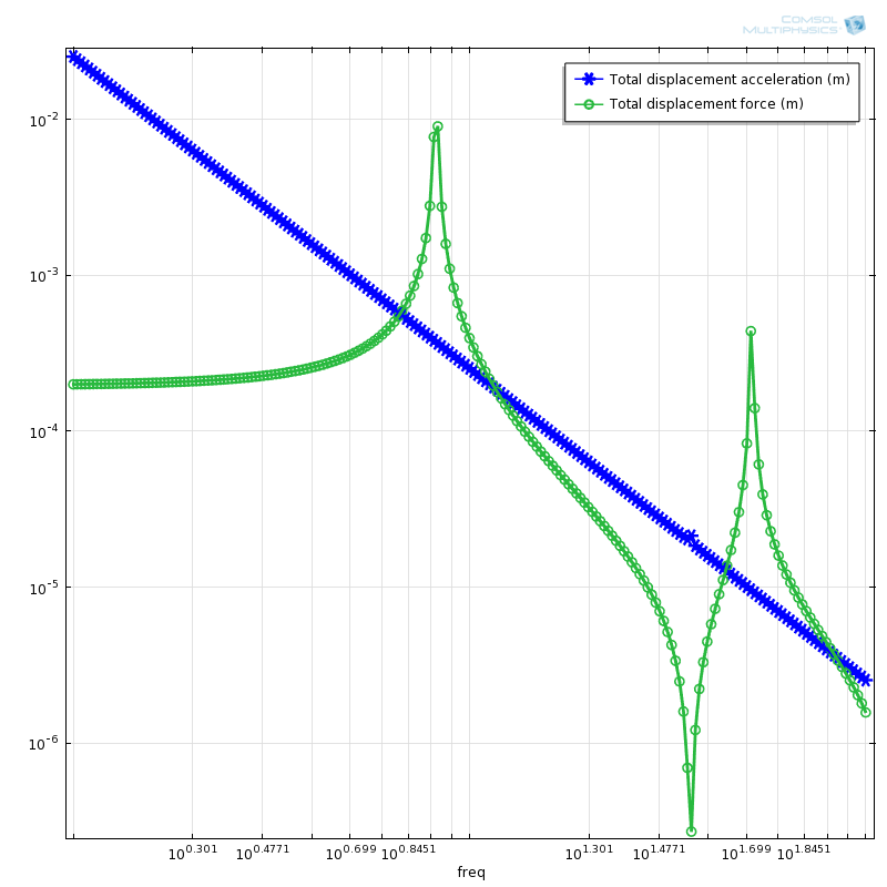

If you apply a shaker test (on a beam just to have an example) you have basically (at least) 2 possibilities:
1) you place the full system on the shaker and you apply a body load from the acceleration of the shaker (your fixed point is also shaking ! hence this is not "just" using the acceleration boundary or domain body load on a fixed lever
2) you attach a boundary to the shaker and you apply locally an excitation force, but the fix point is "fixed" inertially
the responses are different see below.
Take a beam 1, 0.1, 0.01 m^3 (x,y,z) size in structural steel. Attach "fixed" boundary 1 (the first small 0.1x0.01m^2 or y,z plane side), load boundary 6 (the other end of the beam) with an acceleration and then with a Force (both in Z), and do a harmonic scan of the type f=10^{range(0,0.01,2)}
then plot in log/log (or adapt to dB) mode the average "w" or "disp" value of the excited boundary "6" you will not get the same response.
Then, try a domain acceleration => its all wrong so long you do not replace the "fixed" boundary condition by something adapted to the acceleration motion,
something to think over ;)
That is why using COMSOL is fun, you can test quickly on simple examples without braking anything

if you impose an acceleration or a prescribed displacement the response is fixed your harmonic displacement is given or driven via acc=iomega^2*disp
Tryo use a boundary force of 1[N] then you will see the bodeplot if you plot the average tip displacement versus frequency (see my previous graph image above)
Hi if you impose an acceleration or a prescribed displacement the response is fixed your harmonic displacement is given or driven via acc=iomega^2*disp Tryo use a boundary force of 1[N] then you will see the bodeplot if you plot the average tip displacement versus frequency (see my previous graph image above) -- Good luck Ivar

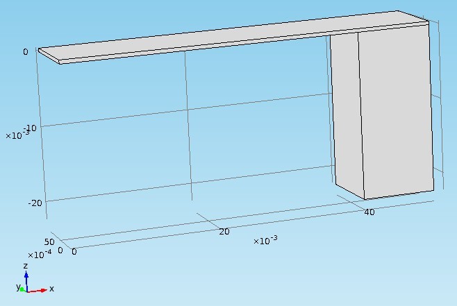

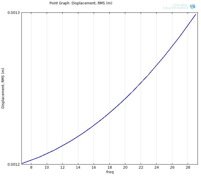

Posted: 1 decade ago 2012/01/14 15:18 GMT-5
This post is a little bit old but maybe someone can help me.
I am trying to do this exact same thing but with a prescribed displacement reprsenting the shaker and I am a bit confused, I try to apply the displacement to the fixed end of the beam and it clear overrides my fixed constraint and my simulation fails.
Am I missing something?
Is there something other than a prescribed displacement that I should be applying?
Thank you in advance.

Posted: 1 decade ago 2012/01/15 3:48 GMT-5
if you have a time dependent displacement signal (lets say for a vertical motion), I would try 1) to model a fixing feature as a slab, then on the vertical edge apply a roller condition 2) perpendicular ones for 3D and impose a vertical "z" prescribed motion on this rigid interface. Then your DUT (device under test) wil lsee a vertical motion, hence also acceleration. I would also add a vertical body load to give the constant gravity as "-solid.rho*g_const"
However, often you can transfor this into a fully fixed feature (I would anyhow add afixation item and let it out for the tress plots just to be sure you have a fully representative I/F (interface) and now stress concetration items) and then add a varying body load deendign on your acceleation spectra
And I would use tha lastest version, 4.0 was really a "first version" of the new interface, many things have been improved since
Hi if you have a time dependent displacement signal (lets say for a vertical motion), I would try 1) to model a fixing feature as a slab, then on the vertical edge apply a roller condition 2) perpendicular ones for 3D and impose a vertical "z" prescribed motion on this rigid interface. Then your DUT (device under test) wil lsee a vertical motion, hence also acceleration. I would also add a vertical body load to give the constant gravity as "-solid.rho*g_const" However, often you can transfor this into a fully fixed feature (I would anyhow add afixation item and let it out for the tress plots just to be sure you have a fully representative I/F (interface) and now stress concetration items) and then add a varying body load deendign on your acceleation spectra And I would use tha lastest version, 4.0 was really a "first version" of the new interface, many things have been improved since -- Good luck Ivar
Posted: 1 decade ago 2012/01/16 16:42 GMT-5
Hi Ivar,
Thank you for the response.
What I actually have is Acceleration vs frequency data that i would like to input, so I'm looking to run a frequency study but instead of having a single constant acceleration I would like to have it varying depending on the frequency value.
It seems like this might be possible but I was getting stuck even applying just an acceleration.
Mikkel

I believe it should be possible with a fequency sweep (harmonic) solver and link the bondary acceleration amplitude to the frequency by an appropriate equation
Hi I believe it should be possible with a fequency sweep (harmonic) solver and link the bondary acceleration amplitude to the frequency by an appropriate equation -- Good luck Ivar
Posted: 1 decade ago 2012/01/17 8:04 GMT-5
Thanks again Ivar, your suggestion of using the rollers seems to have worked out very well
Mikkel
Thanks again Ivar, your suggestion of using the rollers seems to have worked out very well Mikkel

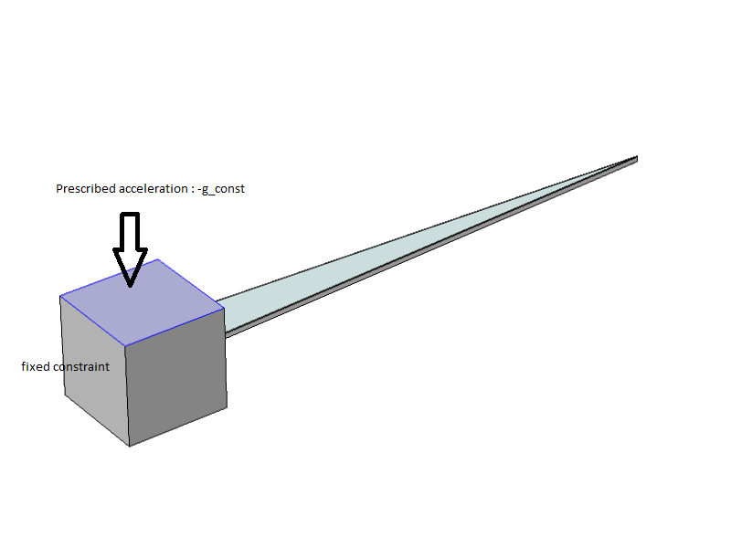

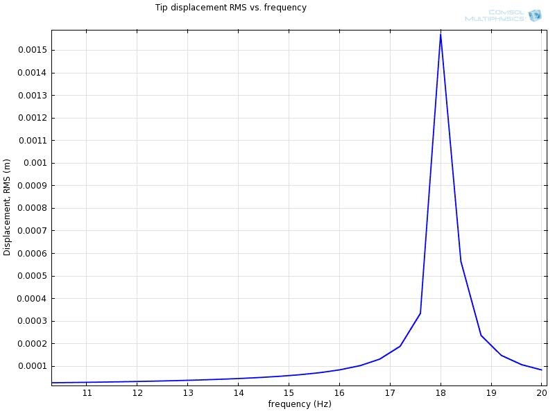

Hello everyone,
I've got a similar problem with a simulation of a vibration test. For easy understanding and a fast simulation I have simplified the model to a beam with the dimensions 1m * 0,02m * 0,02m (x, y ,z), which is fixed on the left end. Now this cantilever should be excited by an acceleration, but I don't know how to define this acceleration in the simulation. The first try was to define a boundary "prescribed acceleration" at the fixed end of this beam, but then the first condition gets overwritten, which is definitely wrong. I've also tried to simulate the beam of Ivar and the same results came out, but this is not the same task. I need a frequency-acceleration plot of this model, where the acceleration amplitudes of this cantilever can clearly be seen due to the eigenfrequencies of it. For example (acceleration of 5 m/s²), for the first 10 Hz there is almost a constant acceleration of 5 m/s², but at the first eigenfrequency of about 16 Hz there is a gain of xxx Q. After that the acceleration goes down and gets higher again at the second eigenfrequency, and so on.
So, how can I simulate this task, where should the acceleration act and also which kind of acceleration should act?
Thank you in advance for your help!!

Posted: 1 decade ago 2012/04/19 5:57 GMT-4
what about using a body load of solid.rho*acceleration. If you want to do a sinus load case, try the frequency harmonic solver with a frequency span start-stop, and perhaps a frequency dependent acceleration.
I'm too missing a simple template as part of COSMOL by default to enter a PSD curve for load definition, so one need to make a function and a parametric PSD input shape, and it works ;)
Hi what about using a body load of solid.rho*acceleration. If you want to do a sinus load case, try the frequency harmonic solver with a frequency span start-stop, and perhaps a frequency dependent acceleration. I'm too missing a simple template as part of COSMOL by default to enter a PSD curve for load definition, so one need to make a function and a parametric PSD input shape, and it works ;) -- Good luck Ivar
Posted: 1 decade ago 2012/04/19 8:19 GMT-4
Hi Ivar,
thank you very much for your answer. I've tried to use a body load and have a question about the simulation results. The acceleration peaks are not realistic, aren't they? And how do I get realistic stress results? If I choose von Mises stress at the eigenfrequencies the stress is much too high. The results are important, because with these values it is possible to choose the right material and/or geometry. The same thing happens if I choose a geometry of 1*0,2*0,2m, where the maximum acceleration is about 1400g...
Another question to your answer, how can I apply a harmonic body load and where can I find the frequency harmonic solver? If I right-click on body load and choose "Harmonic Perturbation" it should be harmonic, but if the simulation gets computed the acceleration is really small (about 1e-4). Do I have to set something else? Or do I have to choose the "Frequency-Domain Modal" Analyses? Because there I get some results, which aren't too low or high...
Last question, how is it possible to generate a PSD curve? I think this is just possible in the time-dependent analyses, isn't it?
Thank you very much for your help!!!!
PS: You can find a acceleration over frequency plot in the attachment of the cantilever example (1*0,02*0,02m) with 5 m/s² body load (steel). Are the results right?
Hi Ivar, thank you very much for your answer. I've tried to use a body load and have a question about the simulation results. The acceleration peaks are not realistic, aren't they? And how do I get realistic stress results? If I choose von Mises stress at the eigenfrequencies the stress is much too high. The results are important, because with these values it is possible to choose the right material and/or geometry. The same thing happens if I choose a geometry of 1*0,2*0,2m, where the maximum acceleration is about 1400g... Another question to your answer, how can I apply a harmonic body load and where can I find the frequency harmonic solver? If I right-click on body load and choose "Harmonic Perturbation" it should be harmonic, but if the simulation gets computed the acceleration is really small (about 1e-4). Do I have to set something else? Or do I have to choose the "Frequency-Domain Modal" Analyses? Because there I get some results, which aren't too low or high... Last question, how is it possible to generate a PSD curve? I think this is just possible in the time-dependent analyses, isn't it? Thank you very much for your help!!!! PS: You can find a acceleration over frequency plot in the attachment of the cantilever example (1*0,02*0,02m) with 5 m/s² body load (steel). Are the results right?
Posted: 1 decade ago 2012/04/19 10:23 GMT-4
I'm not by my WS so I cannot test it out, but why shouldt the amplitudes be correct ? If you apply a body load of g_const*solid.rho its gravity load, and this has always worked for me ;)
What you might see is the Q facor amplification, when you excite the resonance, have you added some damping in your system ? to make it more ralistic ?
Normally, the stress is related to the displacement, so if the displacement is not realistic, certainly the stress is neither not correct.
Have you found the frequency domain solver, check the equation view to see what you can do and what is considered.
One can transfor a PSD to an equivalent frequency sinus sweep response (in LTI system) check the web on virations loads, our the litterature
Hi I'm not by my WS so I cannot test it out, but why shouldt the amplitudes be correct ? If you apply a body load of g_const*solid.rho its gravity load, and this has always worked for me ;) What you might see is the Q facor amplification, when you excite the resonance, have you added some damping in your system ? to make it more ralistic ? Normally, the stress is related to the displacement, so if the displacement is not realistic, certainly the stress is neither not correct. Have you found the frequency domain solver, check the equation view to see what you can do and what is considered. One can transfor a PSD to an equivalent frequency sinus sweep response (in LTI system) check the web on virations loads, our the litterature -- Good luck Ivar

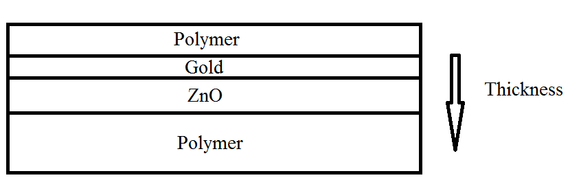

I am trying to simulate frequency response of a MEMS cantilever coated with a piezoelectric material. I have been successful in calculating the natural frequencies. The job remaining is to be able to capture frequency response of the model under the application of a constant acceleration (say 10 m/s^2). What I do not understand is where should I apply the acceleration (i.e. which boundaries!).
I am attaching the model herewith. It will be kind of you to suggest changes in my model.

For some reason I am still not able to simulate the frequency response. I have a cantilever beam which has 3 layer (very thin though 80 nm) of 3 different materials. I have calculated the resonance frequency but the frequency response still does not work. I work in a frequency domain far away from the resonance frequency of the resonator. BUT STILL does not work. "Failed to find a solution for the initial parameter. The relative error (X) is greater than the relative tolerance Returned solution has not converged." It's frustrating!!!!!!! I have tried refining the mesh size, but it does not work either. I am planning to build an accelerometer based on this model.
I am attaching my model. Please, please suggest what should I do!! Also suggest any correction in the "PIEZOELECTRIC DEVICE" node, for obtaining voltage and charges.

First let me thank your for your quick and detailed response. I have few questions regarding your suggestions,
1) I am a beginner with Comsol and I do not know what should be the GND, floating potential, terminal settings. I find the manual insufficient to make users understand these features. They do not have any solved examples on the website. I have searched through this blog to find out worked out models shared by other users but unfortunately there are very few and what is worse is that they are in Comsol 4.2. I would request you to share with us some model on "Piezoelectric accelerometers". This would help many other users who are beginners.
2) I have ZnO as piezoelectric material. Gold is used as an electrode. I can model it as a thin layer. But I can not fild 'thin layer' primitive under the geometry node. Is this something available in the newer versions? I have 4.1.
3) I have tried using 3 elements along the thickness of every element. The natural frequency and the mode shape is the same, but the software is still incapable of performing a frequency sweep.
4) The bottommost and the topmost layers are polymer, so they are not conductors. Frankly, I do not know what electrical connections need to be used for obtaining the voltage and charge generated in the piezolayer during frequency sweep.
I do not want to give up.
-Sankha
Ivar, First let me thank your for your quick and detailed response. I have few questions regarding your suggestions, 1) I am a beginner with Comsol and I do not know what should be the GND, floating potential, terminal settings. I find the manual insufficient to make users understand these features. They do not have any solved examples on the website. I have searched through this blog to find out worked out models shared by other users but unfortunately there are very few and what is worse is that they are in Comsol 4.2. I would request you to share with us some model on "Piezoelectric accelerometers". This would help many other users who are beginners. 2) I have ZnO as piezoelectric material. Gold is used as an electrode. I can model it as a thin layer. But I can not fild 'thin layer' primitive under the geometry node. Is this something available in the newer versions? I have 4.1. 3) I have tried using 3 elements along the thickness of every element. The natural frequency and the mode shape is the same, but the software is still incapable of performing a frequency sweep. 4) The bottommost and the topmost layers are polymer, so they are not conductors. Frankly, I do not know what electrical connections need to be used for obtaining the voltage and charge generated in the piezolayer during frequency sweep. I do not want to give up. -Sankha

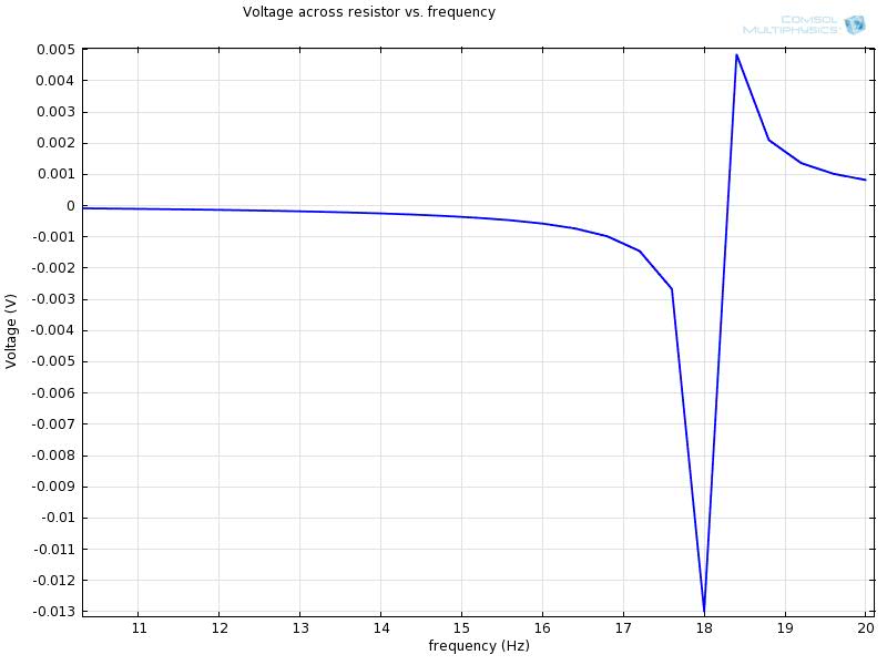

Hi, I am doing the simulation with the cantilever coated by piezo material. When I do the frequency sweep, the cantilever tip displacement and output voltage reach its highest at the resonant frequency. My question is why there is a voltage leap from the negative to positive.
Thank you!
Hi, I am doing the simulation with the cantilever coated by piezo material. When I do the frequency sweep, the cantilever tip displacement and output voltage reach its highest at the resonant frequency. My question is why there is a voltage leap from the negative to positive. Thank you!
Posted: 1 decade ago 2012/06/27 10:45 GMT-4
it has probably to do with the phase lag of your signal which inverses, before the resonance you are driving it, after its the resonance that is ahead of your excitation
Difficult to say more without running a full case
Hi it has probably to do with the phase lag of your signal which inverses, before the resonance you are driving it, after its the resonance that is ahead of your excitation Difficult to say more without running a full case -- Good luck Ivar
Posted: 1 decade ago 2012/06/27 10:51 GMT-4
It is probably a phase issue as Ivar mentioned. Even without piezo effects, before resonance phase angle between force and displacement is 0 and after resonance it is 180 degrees (there is a gradual transition when there is damping).
Nagi Elabbasi
Veryst Engineering
It is probably a phase issue as Ivar mentioned. Even without piezo effects, before resonance phase angle between force and displacement is 0 and after resonance it is 180 degrees (there is a gradual transition when there is damping). Nagi Elabbasi Veryst Engineering
Posted: 1 decade ago 2012/06/27 11:10 GMT-4
indeed for force versus displacement, but if I got it right here it was V out versus force ?
Hi indeed for force versus displacement, but if I got it right here it was V out versus force ? -- Good luck Ivar
Posted: 1 decade ago 2012/06/27 11:16 GMT-4
Is it because Force and the induced Voltage are always in the same phase?

I've tried applying 'prescribed acceleration' to the fixed end of the beam and managed to get the 'voltage vs freq' plot. However, when i do analysis of the beam's deformation at every single frequency, I've found out that the fixed end of the beam moves. It stays fixed only at the natural frequencies. I believe this might be due to 'fixed constraint' is overridden by 'prescribed acceleration'. If 'fixed constraint' overrides 'prescribed acceleration', there will be no output voltage generated.
If I changed the 'prescribed acceleration' to 'body load' of "pzd.rho*acceleration", the fixed end stays fixed throughout the simulation. However, I noticed that the list of eigenfrequencies changed and I'm not sure why.
If I want to plot the voltage distribution at every point accross the length of the beam, should i choose "electric field-Z component"?
Thanks
Hi, I've tried applying 'prescribed acceleration' to the fixed end of the beam and managed to get the 'voltage vs freq' plot. However, when i do analysis of the beam's deformation at every single frequency, I've found out that the fixed end of the beam moves. It stays fixed only at the natural frequencies. I believe this might be due to 'fixed constraint' is overridden by 'prescribed acceleration'. If 'fixed constraint' overrides 'prescribed acceleration', there will be no output voltage generated. If I changed the 'prescribed acceleration' to 'body load' of "pzd.rho*acceleration", the fixed end stays fixed throughout the simulation. However, I noticed that the list of eigenfrequencies changed and I'm not sure why. If I want to plot the voltage distribution at every point accross the length of the beam, should i choose "electric field-Z component"? Thanks
Posted: 1 decade ago 2012/07/22 3:06 GMT-4
indeed if you apply a prscribed acceleration, your object CANNOT be fixed these are antogonists. What you can do is to apply a body load of the type "material.rho*my_acceleration" and keep the fixed section "fixed".
I'm neither not fully happy as today I have not found a clean way to apply a shaker type PSD on a model, in a simple way. there are several threads about this on the Forum, try a search
Hi indeed if you apply a prscribed acceleration, your object CANNOT be fixed these are antogonists. What you can do is to apply a body load of the type "material.rho*my_acceleration" and keep the fixed section "fixed". I'm neither not fully happy as today I have not found a clean way to apply a shaker type PSD on a model, in a simple way. there are several threads about this on the Forum, try a search -- Good luck Ivar

Hi Ivar,
From the attached figure, does my model represent a beam subjected to base excitation? (the beam is attached to a big rigid mass). I've applied body load before to the rigid mass but the output voltage generated is maximum at the fifth eigenfreq. If I changed it to prescribed acceleration and applied it on top of the rigid mass, I can see that the maximum value of voltage is at the first eigenfreq (which is theoretically correct according to my understanding)
thanks
Hi Ivar, From the attached figure, does my model represent a beam subjected to base excitation? (the beam is attached to a big rigid mass). I've applied body load before to the rigid mass but the output voltage generated is maximum at the fifth eigenfreq. If I changed it to prescribed acceleration and applied it on top of the rigid mass, I can see that the maximum value of voltage is at the first eigenfreq (which is theoretically correct according to my understanding) thanks

from you image, you should not use fixed and acceleration simulatneously, but you must use two roller conditions on two opposite sides of your sqare mass at right angle to the acceleration direction. Be sure you large mass is "large" compared to the beam, and then get the correct estimate of the true load on the beam
100V is not necessarily that much, you can get a sparck (>1kV) easily with a stressed PZT, but this also depends strongly on the impedance you connect up on your PZT
Hi from you image, you should not use fixed and acceleration simulatneously, but you must use two roller conditions on two opposite sides of your sqare mass at right angle to the acceleration direction. Be sure you large mass is "large" compared to the beam, and then get the correct estimate of the true load on the beam 100V is not necessarily that much, you can get a sparck (>1kV) easily with a stressed PZT, but this also depends strongly on the impedance you connect up on your PZT -- Good luck Ivar

Posted: 1 decade ago 2012/12/11 22:32 GMT-5
I've applied body load to represent base excitation, and assigned "added mass" BC at the free end of the cantilever ( to represent tip mass). Howver, it shows that the voltage output at the eigenfreq keeps decreasing as the "added mass" increases. I believe by adding the tip mass, the voltage will be increased.
Thanks
Hi, I've applied body load to represent base excitation, and assigned "added mass" BC at the free end of the cantilever ( to represent tip mass). Howver, it shows that the voltage output at the eigenfreq keeps decreasing as the "added mass" increases. I believe by adding the tip mass, the voltage will be increased. Thanks
Posted: 1 decade ago 2012/12/12 1:33 GMT-5
if you add an "added mass then you must also add a boundary force, as the body load applies ONLY forces to the DOMAIN, not to the added mass that is a separate "fictuous " entitiy do not forget that ;)
Hi if you add an "added mass then you must also add a boundary force, as the body load applies ONLY forces to the DOMAIN, not to the added mass that is a separate "fictuous " entitiy do not forget that ;) -- Good luck Ivar
Posted: 1 decade ago 2012/12/12 23:45 GMT-5
The added mass reduces the natural frequency so the voltage may be dropping because the frequency you specified in the frequency domain analysis is no longer close to the beam’s natural frequency.
Posted: 1 decade ago 2012/12/13 0:18 GMT-5
thanks for the reply. in the frequency analysis, I've specified a range of frequency, the eigenfrequency lies within that range.
Thanks.
Hi, thanks for the reply. in the frequency analysis, I've specified a range of frequency, the eigenfrequency lies within that range. Thanks.
Posted: 1 decade ago 2012/12/13 12:03 GMT-5
Ok, one more thing to check. Conceptually, if you apply a certain body load and you change the structure by adding mass the deformations should in general be lower and also the voltage.
Posted: 1 decade ago 2012/12/13 12:59 GMT-5
Hmm,may I know why? Because from what I understand, Adding tip mass to the structure increases the strain,which eventually increases the deformation. Body load is assigned on the "large" mass attached to the beam and added mass is assigned at the other end of the beam,together with boudary load
Thanks
Hmm,may I know why? Because from what I understand, Adding tip mass to the structure increases the strain,which eventually increases the deformation. Body load is assigned on the "large" mass attached to the beam and added mass is assigned at the other end of the beam,together with boudary load Thanks

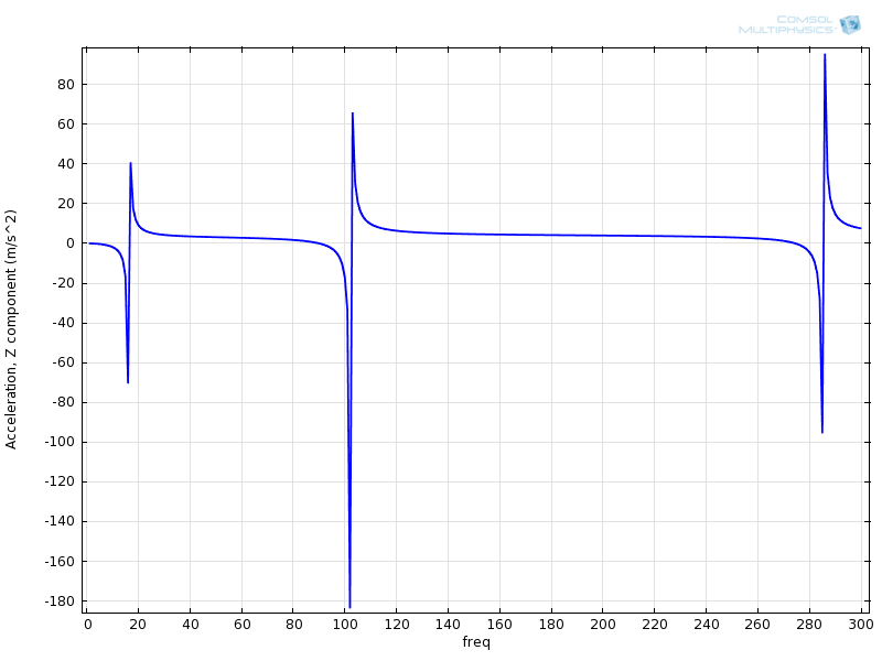

Posted: 1 decade ago 2013/03/13 1:43 GMT-4
Hello all,
This is a very interesting discussion so far and I am trying to make a vibration model along similar lines.
I work with a similar excitation, but with a metal beam fixed at both ends (with compliant mounts) and a shaker applies vibration at the center of the beam with a static preload to hold it in place. Experimentally, I noticed that the resonances observed are of the entire system (shaker + beam) and not the beam alone. The frequencies I use are in several kilohertz where the shaker dimensions do matter.
So, in most of the discussions above where the shaker was attached to the beam, isn't it an issue to consider? Is there a way to include this non-linearity in the comsol model?
Hello all, This is a very interesting discussion so far and I am trying to make a vibration model along similar lines. I work with a similar excitation, but with a metal beam fixed at both ends (with compliant mounts) and a shaker applies vibration at the center of the beam with a static preload to hold it in place. Experimentally, I noticed that the resonances observed are of the entire system (shaker + beam) and not the beam alone. The frequencies I use are in several kilohertz where the shaker dimensions do matter. So, in most of the discussions above where the shaker was attached to the beam, isn't it an issue to consider? Is there a way to include this non-linearity in the comsol model?
Posted: 1 decade ago 2013/03/13 7:01 GMT-4
in all generality the "thumb" rules:
2*pi*freq = sqrt(k_stiff / mass) = sqrt(k_rot / Inertia),
and for a beam under gravity load, for the first mode gies about the max deflection
2*pi*freq = sqrt(g_const / Dz_deflection)
I a rather good approximation. So if you add a mas via your attachment to a shaker, it is clesr that you will influence the mode to. That is why one often attach the FULL system to the shaker, or we shake the base and not the directly part of structure itself under test. At least not with any mass of significance w.r.t. the object mass
Hi in all generality the "thumb" rules: 2*pi*freq = sqrt(k_stiff / mass) = sqrt(k_rot / Inertia), and for a beam under gravity load, for the first mode gies about the max deflection 2*pi*freq = sqrt(g_const / Dz_deflection) I a rather good approximation. So if you add a mas via your attachment to a shaker, it is clesr that you will influence the mode to. That is why one often attach the FULL system to the shaker, or we shake the base and not the directly part of structure itself under test. At least not with any mass of significance w.r.t. the object mass -- Good luck Ivar
