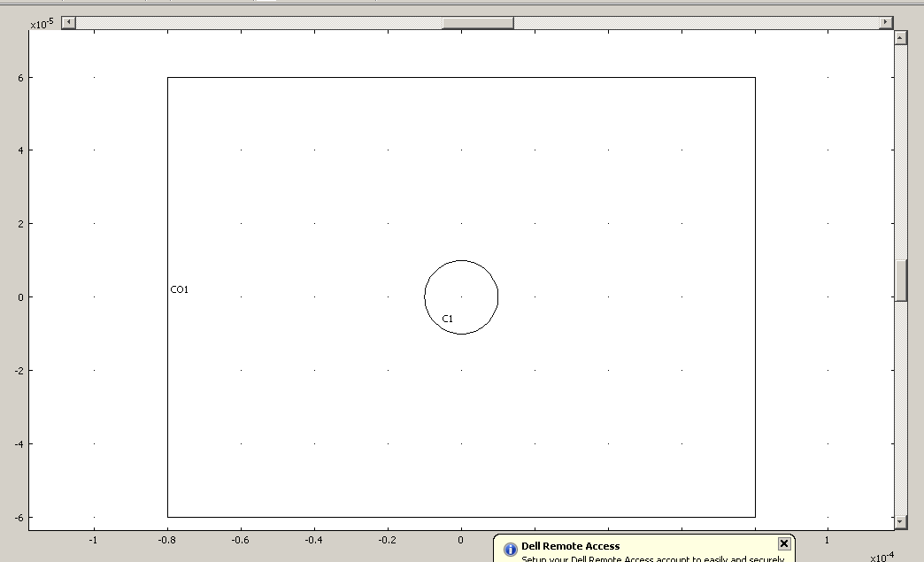

Well, actually I have made some progress since my message was posted. I’ve realized I can change the thickness of the cross section: I’ve changed it to 150 ?m, so now it fits better with my model dimensions (160 ?m *120 ?m). After changing the thickness I found it logical to use the blood pressure value…
As I’m not interested in the blood flow but rather interested in the heat exchange and the load blood exerts on the vessel wall, I’ve decided not to use the fluid application: I’me using the structural mechanics plane strain modulo and bioheat equation from the heat transfer.

                                                    Well, trying to solve the transient problem using time steps of 0:10:1000 I’ve managed to get a solution (using the steady state as initial value).
I’ve added now the bioheat from the heat transfer modulo and created a coupled problem (structural and thermal). Trying to solve the coupled problem I think that the thermal solution that is received in the coupled problem is less accurate than in the thermal problem modeled by itself…  or at least this is how it is visualized in the thermal map…
Can it be? Is there a tradeoff in accuracy when solving coupled problems?
