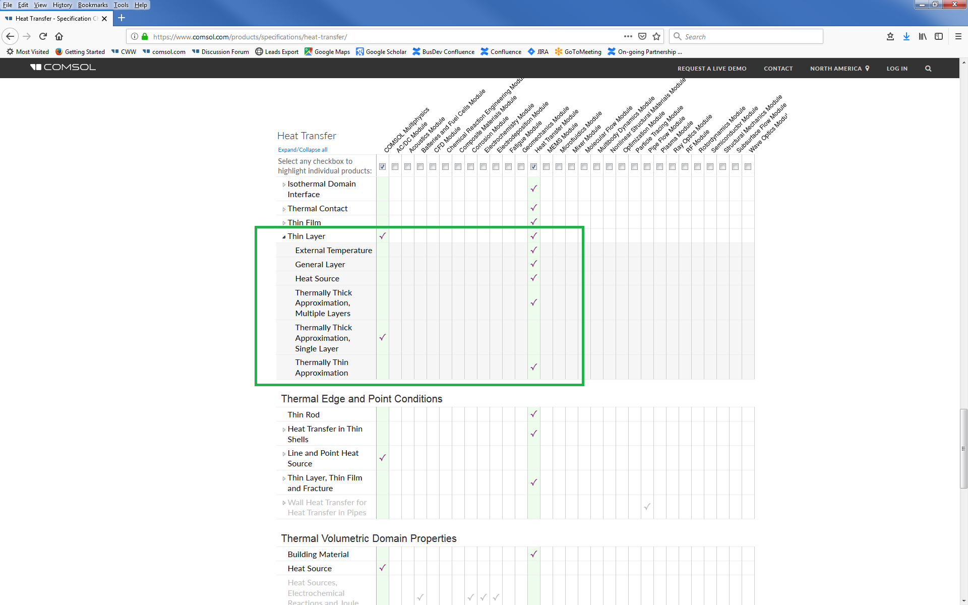

Jeff Hiller COMSOL Employee
Posted: 6 years ago 2018/12/19 8:36 GMT-5
The attached screenshot (from the "Specification Chart" on our website) compares what's in the core package vs the Heat Transfer Module as far as Thin Layers on boundaries.
Contact your COMSOL rep for a trial of the Heat Transfer Module: www.comsol.com/contact.
Jeff Hiller
The attached screenshot (from the "Specification Chart" on our website) compares what's in the core package vs the Heat Transfer Module as far as Thin Layers on boundaries. Contact your COMSOL rep for a trial of the Heat Transfer Module: www.comsol.com/contact. Jeff
