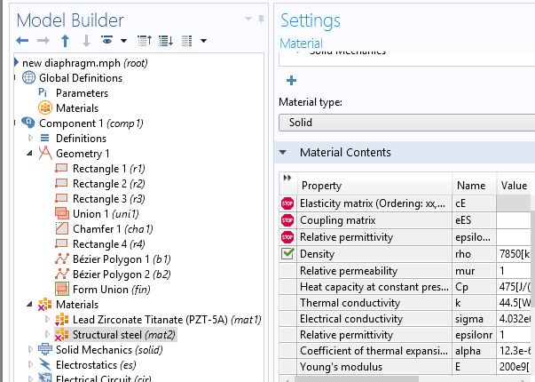

Need the Elasticity matrix, coupling matrix, relative permittivity values of structural steel
Hi, Came up in developing a piezoelectric energy harvesting model and included structural steel in between. But after including domains it showed this error
Need the Elasticity matrix, coupling matrix, relative permittivity values of structural steel in figure. Kindly help me in this regard

If you make steel a linear elastic material (as it is) you will not need these parameters.
Posted: 7 years ago 2018/12/23 13:59 GMT-5
You must remove the steel domains from the piezoelectric material model node and put it into a linear elastic model node.

Thanks so much all. Cleared the problem.
