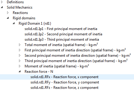

I assume that you are referring to the Prescribed Displacement/Rotation subnode on a Rigid Domain.
You need to select the Evaluate reaction forces check box in the Reaction Force Settings section. Then, reaction forces will be available when you work with global results, as shown in the attached screenshot.

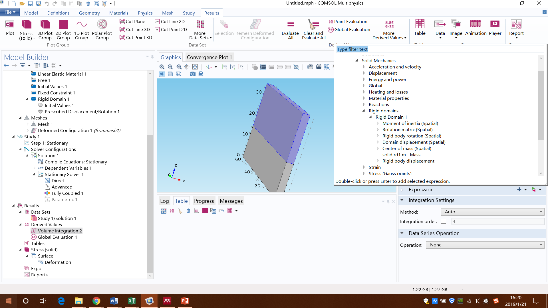

However, I didn't find the reaction force under rigid domain section.
I attached the screenshot below.
Could you tell me where I did it wrong?
Thanks, Ke Wu
Thanks so much for your reply! However, I didn't find the reaction force under rigid domain section. I attached the screenshot below. Could you tell me where I did it wrong? Thanks, Ke Wu
Posted: 6 years ago 2019/01/22 3:39 GMT-5
You need to do a Global Evaluation. The reaction force on a rigid domain is a scalar result and not a field in the domain.
