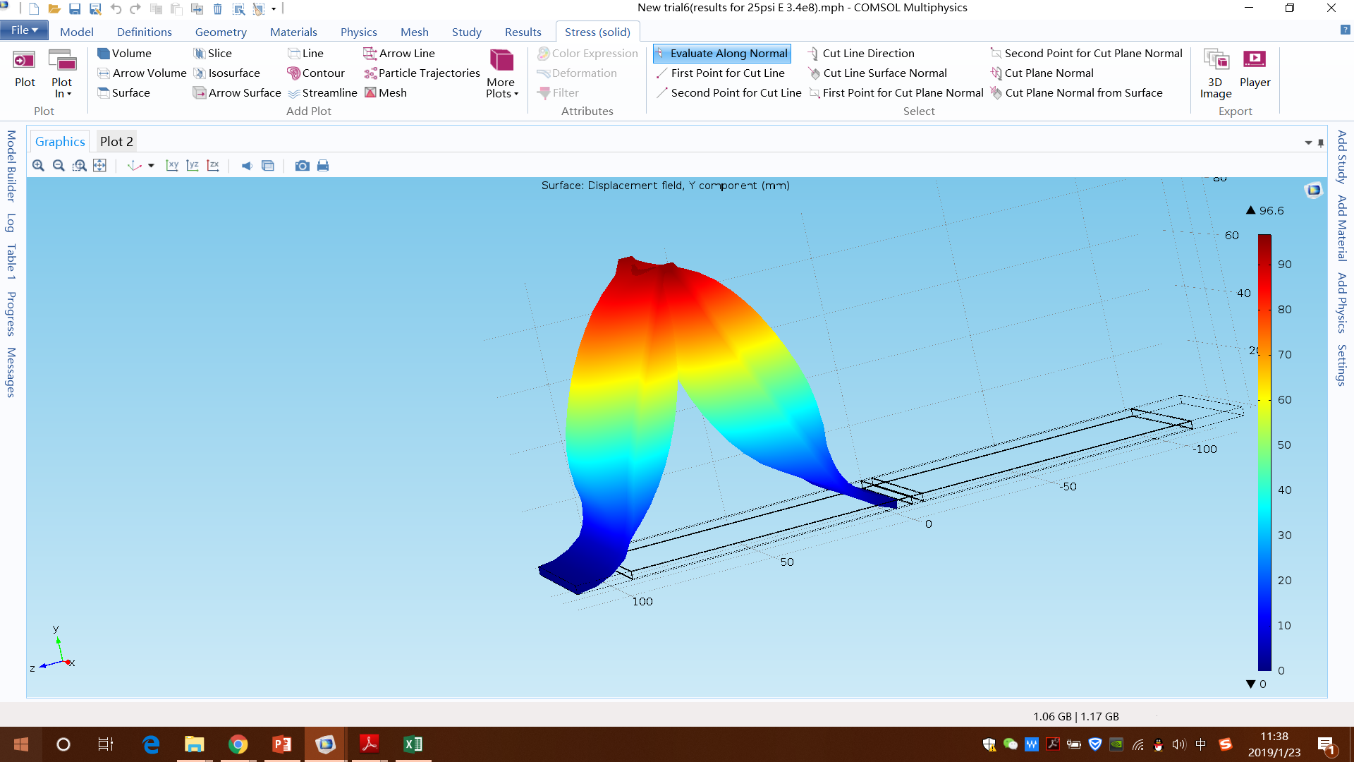

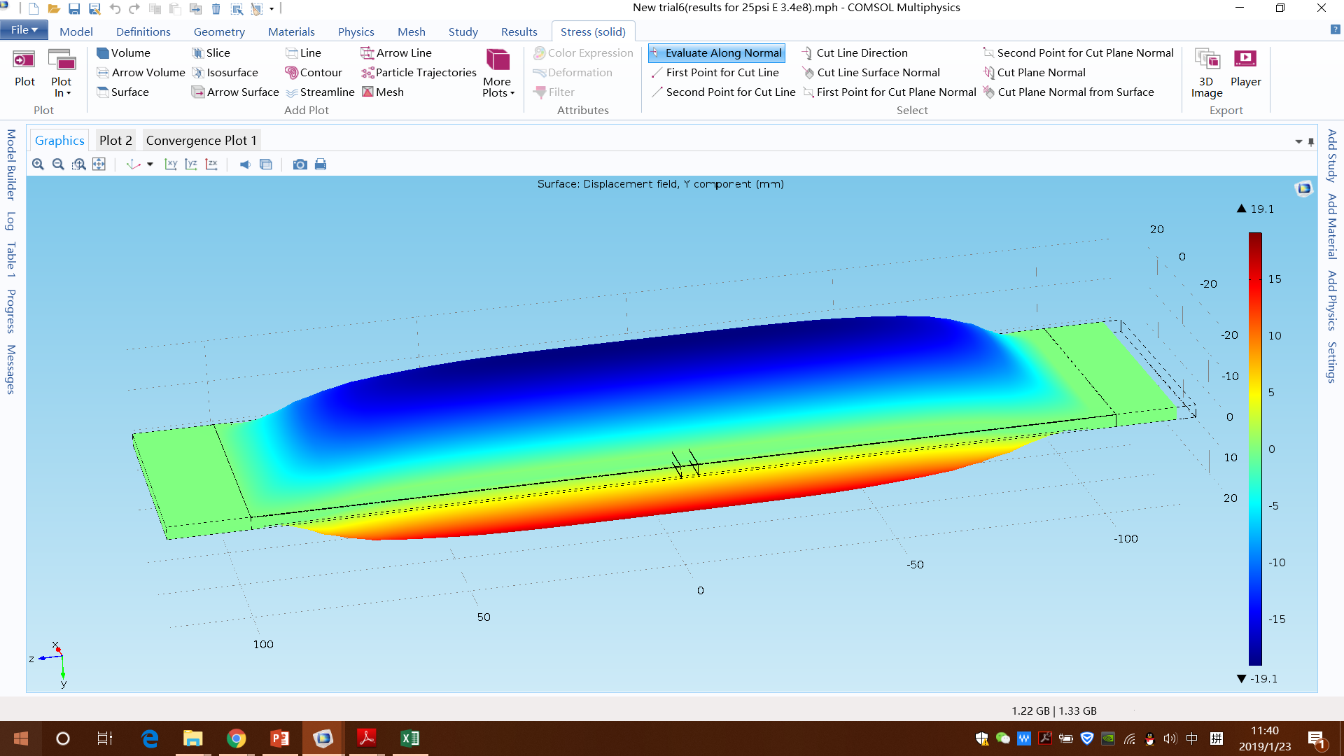

Can I use shell interface instead considering membrane is so hard to converge?
What I am modeling is an airtight cloth with inner pressure inside.
The idea is to set a prescribed distance at its center to get its corresponding reaction force.
I've attached 2 screen shots below.
Thanks in advance, Ke Wu
Thank you so much! Can I use shell interface instead considering membrane is so hard to converge? What I am modeling is an airtight cloth with inner pressure inside. The idea is to set a prescribed distance at its center to get its corresponding reaction force. I've attached 2 screen shots below. Thanks in advance, Ke Wu

You can use the Shell interface. The reason not to do that is that as the bending stiffness gets smaller, the numerics gets more and more ill-conditioned. But as long as the solver does not throw warnings or errors at you, a shell solution will work. Due to the bending stiffness there will be no tendency to wrinkling.
