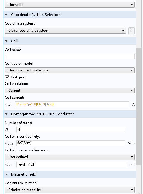

I am trying to put this current (Picture's attached) and Comsol is giving an error which is "Unexpected unit of input", can somebody guide me?

As you set it up, the expression inside the sine has units of Hz, because you effectively non-dimensionalized time by adding the [1/s]. Remove the [1/s] or the [Hz] (but not both) and you'll be all set.

Hello Hassan, As you set it up, the expression inside the sine has units of Hz, because you effectively non-dimensionalized time by adding the [1/s]. Remove the [1/s] or the [Hz] (but not both) and you'll be all set. Best, Jeff
