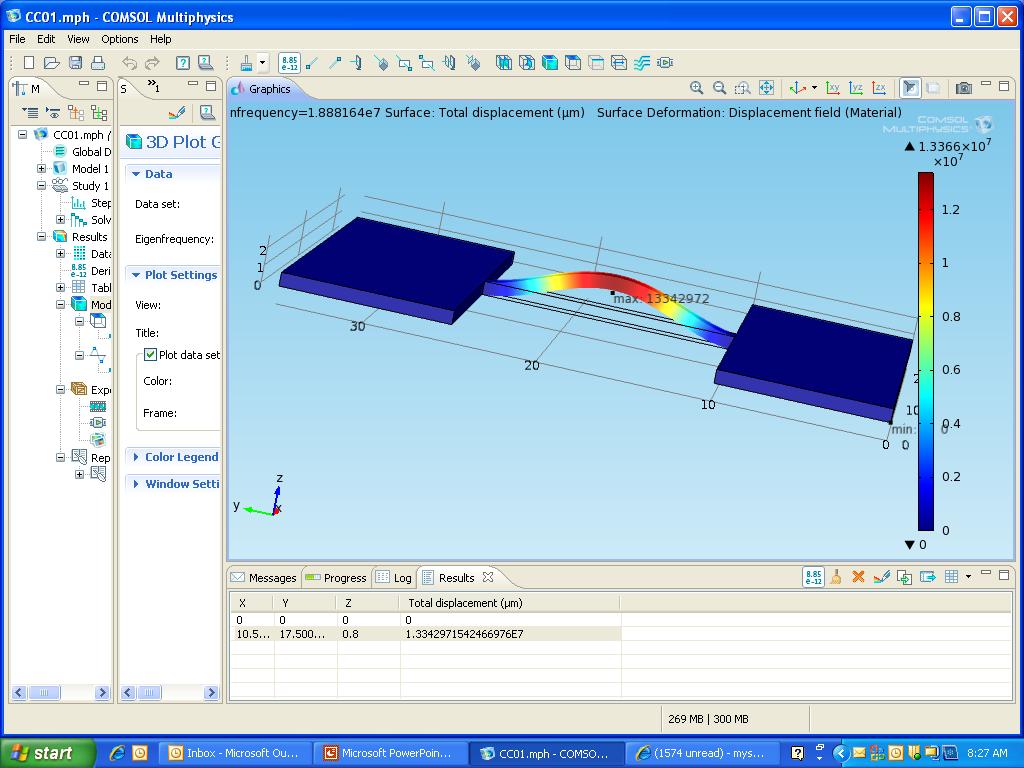

I have question regarding about on how to find the x,y,z axis displacement.
Currently I'm using Comsol 4.2 and attached are the file of my result. Is it correct because i'm quite confius about the result. Can everyone verify my result?

because of the large displacement values for the eigenmode analysis ?
If so, reread the theory around eigenmode analysis:
You will then notice that amplitudes are not restrained, one can only get:
1) frequencies,
2) relative shapes
3) if you chose the correct normalisation, relative mode energy comparison.
But you never get any absolute displacement values.
I believe that the COMSOL developpers have left this feature (normalisation) this way as the default to REMIND all users about this effect. (at least for those noticing the large displacements and then ask themselves the question why )
